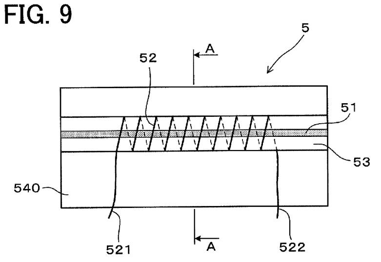

Thanks for your answer. You're saying that each "rectangular coil" that they said in the description *is* the MI element (magnetoimpedance)? Or the core is the MI element? All the examples I've seen have the MI element as a piece of amorphous wire where the AC current flows, but without a coil.
Also, by your explanation, there should be two MI elements, right?

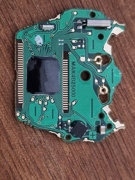

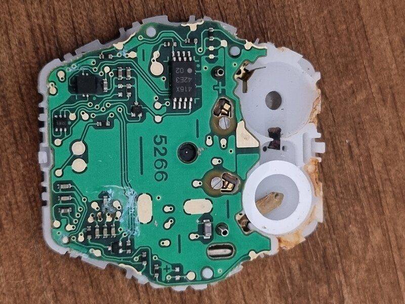

Now, I remembered that I had an old, broken SGW-500H watch that also have the twin sensor (compass and thermometer), probably the same as my Edifice. So, out of curiosity, I opened it. Here are the pictures:
Front of the board:
We can see that there is no big ass coil ass they shownin the website description and pictures, at least not for those twin sensor models.
I believe the left gray cilinder is the quartz crystal. So, the right round box with the black square on top must be the compass sensor? And maybe that little yellow component on top right is the thermistor? Anyway, if there are coils, they are really, really small and inside that little box.
What you think?
Nice photos! Much better than we usually see here. :smile:
The combination, or assembly, of coil and core would be the MI element.
I see a black square on the front of the board near one edge, I would consider that a prime suspect of being the MI sensor. I can't find a 'round box with the black square' in the photos.

Thanks! Ok, so the coil is around the MI. And there are probably two sets of coils-MI to get teo axis and give directions (the watch doesn't hsve 3 axis conpass and must be parallel to the ground for accurate reading). Now, what does the coil do exactly? Why can't the MI be used line a thermistor?
And yes, that's exactly the box I was talking about. In the sngle of the photo you can't see, but underneath the black square there is a roundish metalic component. It is mostnlikely the MI sensor (idk if the thermistor is inside too or is the yellow thing above it). I can take others pictures from other angles if you like.

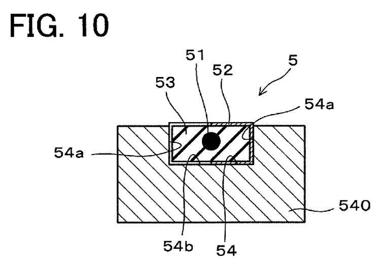

Because the characteristic of the MI material that changes can not be measured as an electrical quantity. Its magnetic characteristic changes.
The coil would create an changing magnetic field that is then modified by the MI. This modified magnetic field then interacts with the coil, inducing a voltage that can be sensed as a change in electrical characteristics.

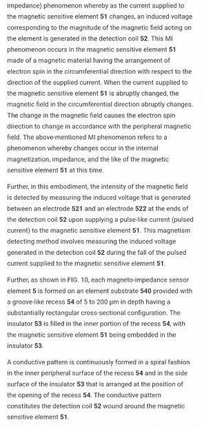

Don't MI change the impedance (an electrical quantity)? Magnetic quantity would be permissivity.
The coil isn't to pick up the field?
I thought it would work like this:
There is an AC source that will feed the MI element. That AC will induce a voltage in the coils that are around it. That induced voltage is measured. When there is an external field present, the voltage will be different. With that difference we can calculate the external field.
Is that right?

OK, I did some more research and you are right. I found an explanation of the
Magneto-Impedance Sensor here:
https://www.jst.go.jp/chizai/en/cips_details/pdf_2/3-8.pdf
The technology itself has a claimed dynamic range, 10-8 to 102 Gauss. The assembled device claims a range of ±4Gauss, resolution 0.1mG, and sensitivity of 500mV/G. WOW!
The link above gives the theory as you described and the sensitivity equations, it also has the (Japanese) patent numbers for those wishing a more detailed description.

Hey, I should thank you all for helping and not getting bored of my persistence.
This link here also describes the MI very clearly:
https://www.freepatentsonline.com/7278219.html
It's a big text, and the only part that matters is this one:
TL;DR: There is an AC current in the MI (51 in the figures). As the AC current is changing over time, a magnetic field around that wire+MI will appear. That changing field will induce a voltage on the coil (52) that is around the MI. That voltage is measured. When there is an external magnetic field, the MI impedance changes and hence the AC current changes. And then the magnetic field changes and consequently the induced voltage on the pickup coil (52) also changes. That difference can be used to calculate the external field.
In this patent there are 3 MI elements used in a car. The watch has 2, so it needs to be parsllel to the ground.
The MI is needed because a regular resistance would not change the current enough in the presence of the mag field. The MI gives a lot of sensibility to the sensor. And a simple coil of that tiny, tiny size without an excited core would also no have enough juice to get a sensitive reading. Also, if there was only a coil, there would be no induced voltage, since Earth's magnetic field is practically constant.
Now, I only have one question:
1- The mag. field created by the AC current through the MI will be circles around it. The pickup coil is also circles around it. So the coil and the mag. field are parallel to each other. There would be no induced voltage in a coil parallel to the field (there must be an angle between them). Is my understanding wrong? Maybe the coil isn't just a wire wonded around the MI, but a spiral wonded around it? English is not my native tongue and I couldn't be sure reading the explanation posted or the images. Could someone confirm if the coil is in fact an spiral? If that's the case, then there would be an angle of 90º between the field and the area of the spiral, right?
