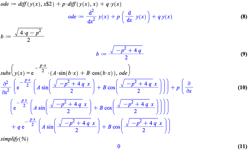

Here is what I mean

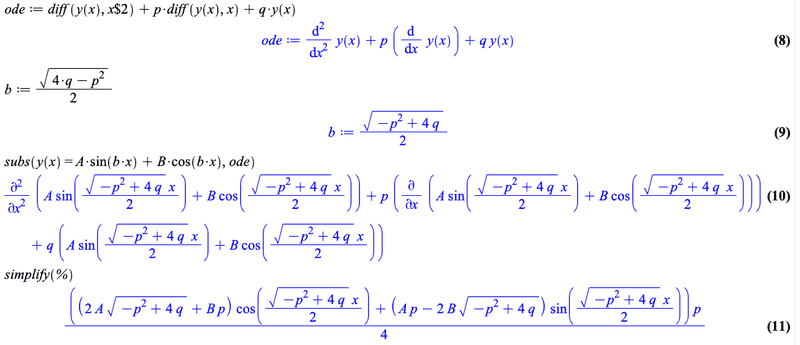

Now, I straight up subbed in ##y_p## into the original differential equation without imposing any conditions.
However, in the final expression above, namely (11), it isn't clear at all what is required to make the expression zero.

I think I forgot an exponential factor
$$y_g(x)=e^{-px/2}(c_1\sin{kx}+c_2\cos{kx})$$
Now the calculation seems correct.

Indeed, it has been bothering me as well that the result was zero without actually assuming that the discriminant is smaller than zero. Nonetheless, the software (Maple) does give zero.
I am here trying to figure out why.

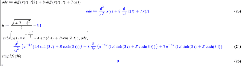

To summarize the issue: it seems that a damped sinusoidal in which the angular frequency is ##\frac{\sqrt{-\Delta}}{2}## is a solution to the homogeneous equation even when the discriminant is positive.
Note that in this case the argument of the sine and cosine functions is complex. The following example illustrates all this.
The differential equation ##x''+8x'+7x=0## has positive discriminant ##\Delta =36## and thus two distinct real roots ##-1## and ##-7##.
If we let ##b=\frac{\sqrt{-\Delta}}{2}=\frac{\sqrt{-36}}{2}=3i## then
$$x(t)=e^{-pt/2}(A\sin{bt}+B\cos{bt})$$
is a solution.

That's not what your Maple output shows, which is ##x(t) = e^{-4t}(A\sinh(3t) + B\cosh(3t)##.
Notice that you omitted the ##e^{-4t}## factor above, as well as the hyperbolic trig functions.

But that’s the point. This isn’t a homogeneous solution. You need the exponential factor. Once it is there you will not get zero when you insert a constant amplitude sine as the particular solution. You solve for its phase and amplitude and then all is well (assuming ##p\neq0##). This is just a damped harmonic oscillator and if you drive it with a sine you get a constant amplitude sine as the long time solution.

Indeed I forgot the exponential again.
As for your comment on hyperbolic trig functions, note that the command in question subs into the original DE the proposed solution ##x(t)=e^{-4t}(A\sin{3it}+B\cos{3it})##.
Maple outputs a long output that includes hyperbolic trig functions but when I ask it to simplify the output it is simply 0.
So I didn't omit any hyperbolic trig functions. Those are only there because that is how Maple is choosing to represent the expression after the substitution of the ##x(t)## which does not contain hyperbolic trig functions.
