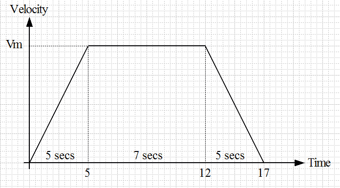

Yes, you get to the same result. A graphical depiction to begin can sometimes help. For example:
You know the area must be your displacement, you have the time periods, the only thing you don't have is the maximum velocity Vm. But Vm is easily found given the other information. Acceleration is just the slope of a line in the figure.

You seem to have understood the graphical approach. I'd say that's one thing never to forget: displacement = area under the velocity vs time graph.
Regarding average velocity. For constant acceleration from or to rest, the average velocity is half the final or initial velocity respectively. More generally, if you accelerate from ##u## to ##v## at a constant acceleration, then the average velocity is ##(u+v)/2##. You can check that graphically.
Another approach was to note the symmetry of the motion. Although, in this case, that just makes things a little easier. Always look out for symmetry in a problem. As problems get harder, using the symmetry of a problem can makes things a lot easier. And I mean a lot!

Thank you very much, this was very helpful.
