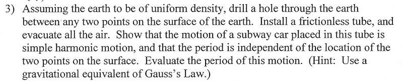

I need help starting and solving this problem. See attachment for problem.
  • Typed homework problem 3: assuming uniform Earth density, drill a hole between two surface points, install an evacuated frictionless tube, show subway car motion is simple harmonic with period independent of endpoints, evaluate period, hint Gauss's Law.

you first need to show some genuine attempt yourself so that we can help you!
Try to find the equation for the gravitational field at a point within the Earth using gauss' law for gravity which is:
[tex]\oint_S \vec g \cdot d \vec A = - 4 \pi G \oint_V \rho dV[/tex]
If you haven't see the symbol [tex]\oint[/tex] it simply means that the integration is being taken over a closed surface or volume.

Here is what I have done:
Mass Earth = volume time (row) which is density
so M = 4/3 pi r^3 times row
so F= -GMm all over R^2 sub Mass Earth for big m (Question why do I sub for big not little m)
and get
f= -(4/3piG(row))mR
this has the form f = -kx so k = 4/3 piG(row) m
and T = 2pi times square root of m over k sub for k and get 2 pi times square root of 3pi all over row times G.
My question is how did my friend get that answer for the period and what do I do next?

Yes for a differential equation of the form
[tex]\ddot x = - (\omega_0)^2 x[/tex]
where the dots denote time derivatives
the general solution is
[tex]x = A cos( \omega_0 t - \delta )[/tex]
and from here you can find the period as
[tex]T = \frac{2 \pi}{\omega_0}[/tex]
If you are wondering how to solve differential equations like this for yourself, the best way is to simply guess. We want a function whose second derivative is equal to a negative multiple of itself. What can you think of? There are only a few things that can satisfy such an equation. Sine and cosine, and exponential functions of imaginary numbers, which actually turn out to be equivalent. For example:
