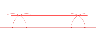

What need for tangents?
Compass-and-straightedge construction in red: two horizontal lines with arcs drawn from points on the lower line, intersecting an upper line to form a parallel.
Red compass-and-straightedge construction: two pairs of intersecting arcs drawn above a horizontal base line, with a horizontal red line connecting the arc intersections above the base line.
Your drawing shows 4 arcs, while @Lnewban's tangent is common to 2 arcs:
Well yeah, but a bad idea is a bad idea.
Of course it's true that you don't need tangents to construct parallel lines, but I wouldn't call the quick method posted by @Lnewqban a bad idea ##-## it's fast and simple, and could be practical for e.g. carpentry or masonry purposes, in that you can set the compass to the distance at which you want the parallel line.

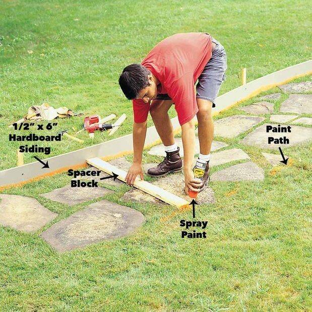

Not too precise, but not a bad method when you need to field-layout a parallel of a sequence of irregular curves, like when building a sidewalk or road that follows a twisting course.
Please, see:
https://en.wikipedia.org/wiki/Parallel_curve
A man in a red shirt and work boots spray-paints an orange line on grass beside a flagstone path, using a wooden spacer block set against the stones; labelled 1/2" x 6" hardboard siding, spacer block, spray paint and paint path.
