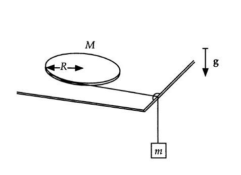

A plane, homogeneous disk may slide on a frictionless horizontal table. A
light cord is fastened to the disk and wrapped many times around the rim of
the disk. The cord goes without friction through a small eyelet at the edge
of the table and is connected to a mass m (see the figure). The mass of the
disk is M and its radius is R. The system is started from rest and the cord
is assumed to be taut throughout the motion. Ignore the mass of the cord.
(1) Find the velocity v of the center of mass of the disk as a function of time
(before the disk hits the eyelet or the mass m hits the floor).
N = dL/dt
mgR = d(mvR + MvR + ½M(R^2)v/R)/dt
mgR = ma + Ma + ½Ma
mg = a(m + 3/2M)
v = mgt / (m+3/2M)
My answer is incorrect. The right answer is v = mgt/(3m+M), but I have no idea what I'm doing wrong.

What axis are you taking moments about that results in mvR+MvR?
Are you supposing m has velocity v?
If I will consider an axis passing through the center of mass, should I take into account only the momentum derived from rotation: Iω?
I assumed the velocity of m and M will be the same. If not, how should I calculate the velocity of m? I have tried to use the conservation of energy, but I don't know how to deal with calculation of potential energy of both masses.

The linear velocity of the disc's centre has no moment about that centre.
Since the disc is rotating, the velocity of the mass centre of the disc will not be the same as the velocity of the suspended mass. What will the relationship be?
Oh, and the disc's angular acceleration is not d(vR)/dt.

Sure, but angular momentum about the disc centre, coupled with linear acceleration, is fine too. All the ways I can find require two equations regarding torque/force/energy, plus one to relate the angular and linear accelerations.

I think this can be solved by using typical Newtonian mechanics reasoning, making two equations for the movement of the two CMs, and one equation for the rotation of the disk. You ll end up calculating the tension on the string too this way along with the two linear accelerations and the angular acceleration.
The tricky part here is that the equation ##a=\alpha R## holds between the linear acceleration of the mass m and the angular acceleration of the disk.

If the string unwinds by x around the disk, then the disk rotates by angle ##\phi=\frac{x}{R}## and the mass m goes down by x as well. @wrobel you got any disagreement with the above reasoning?
you do not take into account that the center of the disk moves
I see now i think you are right after all, thanks for the correction.
is the correct equation $$x_m=\phi R+x_{disk}$$
then?

I assume here you are referring to the point that is stationary, i.e. the instantaneous centre of rotation.
It is hard to guess this in advance. As I posted, it is best to consider the disc's motion as the sum of a linear acceleration of the mass centre and an angular acceleration about that centre.
If the tension in the string is T then, that being the only force acting horizontally on the disc, the linear acceleration is a=T/M.
The torque the string exerts about the disc's centre is RT, so the angular acceleration is given by ##I\alpha=RT##. With ##I=\frac 12 MR^2##, we have ##M\alpha R=2T##.
We can get the corresponding velocities at time t by multiplying each by t.
Suppose the instantaneous centre of rotation is distance X from the disc's centre, distance X+R from where the string leaves the disc. We have ##X\alpha=a##, so ##2TX=MX\alpha R=MaR=TR##, whence X=R/2.
