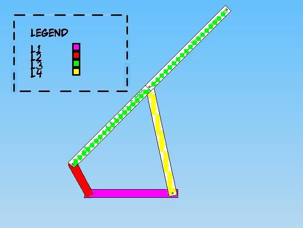

I've calculated a straight line mechanism for a 15cm straight line...
39% straightness over the cycle...
lengths came out to
L1 = 10.35cm
L2 = 4.14cm
L3 = 13.445 = L4
these values should give a 15cm line... so I went to go build the thing.. all the distances from each hole on each link are exactly those numbers I worked out... but the length of the straight line came out to 20cm.
the formulas are:
15cm/L2 = 3.623
L3/L2 = 3.25
L1/L2 = 2.5
Any idea why my model didn't work out to what it should of been...
