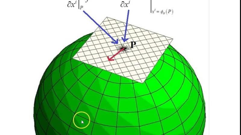

Let's take your example of angles on a 2-sphere. At any point on the 2-sphere, we can generate a flat tangent plane to the sphere at that point. An illustration from a random webpage might be helpful here.
Then you can measure the angle in the flat tangent space.

Note that finite displacements on the sphere are not vectors. As Misner remarked, if you go 500 miles north and 500 miles east on the surface of the Earth (modeled for the sake of the example as a sphere), you do not necessarily wind up at the same location as if you go 500 miles east then 500 miles north. But this difficulty doesn't arise in the tangent plane to the sphere, in fact vectors on a sphere are commonly regarded as existing in the tangent space, with every point on the sphere having it's own tangent space.
