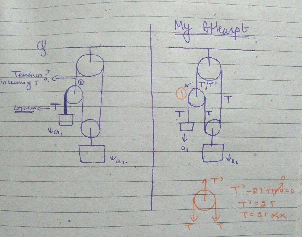

Whats the tension T' in string 1 if tension of highlighted string is T

I have attached image of question as well as my attempt!
If we consider string as uniform then T'=T but if make fbd of pulley 1 the T'-2T-ma1=0 = T'=2T as m=0 for the given pulley. This is contradicting
