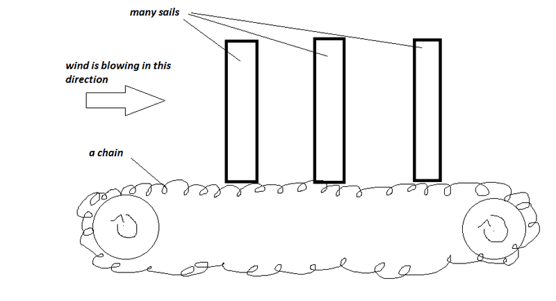

Hello,
a friend of mine has a "revolutionary" idea about harvesting wind power by using a "translational turbine". however, it all sounds silly to me. this is what it should look like:
is this a good idea for a wind "turbine"?
Hand-drawn sketch of a chain loop on two wheels, with three vertical rectangular sails attached to the top run of the chain; an arrow labelled wind is blowing in this direction points right.
It looks like a very poor idea,
The sails downwind of the first sail are in the lee of the first sail so will do no work.
Unless there is a mechanism (not shown) to furl the sails on the underside of the chain they will be opposing the sails on top.
There is no mechanism to keep the device heading into the wind.
Colin Chapman (founder of Lotus cars) is quoted as saying "simplify and add lightness" this idea is the reverse of CCs philosophy.
If your friend knew something about sailing, he would know that a sailing boat will go faster at a beam reach (perpendicular to the wind) than directly downwind.
The sails will be screening each other.
The sails will have to go back upwind and will have to fold or be screened somehow.
Youl'll need two masts to raise the whole contraption off the ground.
An ordinary 3 bladed wind turbine is just 3 sails, that go in the optimal direction, don't screen each other, are active all the time, and can be raised off the ground much easier to catch more wind at a higher altitude.
The design will "work" in the sense that sticking any large surface into the wind and linking it to the axle of a generator will "work" - the question is: is it efficient?
It isn't. Just a few reasons why have been listed.
Having come up with a different idea doesn't mean one has come up with a good idea.

Frankly, we don't know what angle the wind is to the sails in the OP's example. For all we know, it could be on a Broad Reach. But without any details as to how it's controlled and oriented, it's impossible to say.
We should keep in mind that the OP's interpretation of the design is not the inventor's design. The inventor could well have answers to all these problems, for all we know. The only thing we can really say is that there is not enough information given in the diagram.
I think your friend could look at the http://www.planetarysystems.com/productD.php?PtID=13 idea. It uses vertical blades, mounted around a vertical spindle. It is very successful for small generators and pumps but I haven't seen the design used for large scale power.
It is not unlike his idea except that it nicely takes care of the problem of getting each blade back to the beginning again (they go round the back and push in the appropriate / opposite sense) and works with the wind from any direction.
A chain drive like he proposes would be very inefficient, too, compared with a rotary motion on a single bearing.

Do you think the optimal number of blades is always three, independent of the wind speed?
The optimal number will depend upon the size of the turbine, I think.
Many small turbines have more than three - certainly, the classic designs for water pumps in Western Movies has up to eight (?). I have (a modern) one on my boat with six blades.
