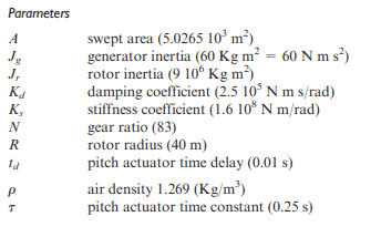

I calculated from some papers of windmills a moment of inertia of 113,000 kgm2
Equation: where J = (J_r + N^2 J_g) / N is a lumped rotational inertia of the system.
And from this paper there are some values: https://core.ac.uk/download/pdf/70596755.pdf
Parameters list for a wind turbine model: swept area 5.0265 x 10^3 m2, generator inertia 60 kg m2, rotor inertia 9 x 10^6 kg m2, damping coefficient 2.5 x 10^5 N m s/rad, stiffness coefficient 1.6 x 10^8 N m/rad, gear ratio 83, rotor radius 40 m, pitch actuator time delay 0.01 s, air density 1.269 kg/m3, pitch actuator time constant 0.25 s.
Yes, as you said, I think also there is a 10 factor missing or something.
Neonwarrior
neonwarrior said:
Net torque = J . (DELTA w)/ 5 seconds = 785.4 Nm
Same here -- from the given data.
##I## is the symbol of choice for moment of inertia. With three blades times ##{1\over 3} ML^2##, 50 m long wings you would have left over 1 kg of mass for each wing :oldlaugh: if the total ##I## is 7500 kg m2
These guys mention 12.5 tonne per blade... so more like a factor of 10000 ...
