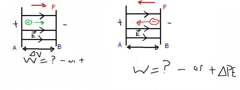

I have been trying to grasp the concept of work and electric potential energy inbetween two parallel plates with a uniform electric field and it is quite confusing. can someone explain when is work done = negative electric potential and when is it positive electric potential. i have been trying to figure this out for 3 days now please tell me straight forward.
Think like the only thing given is change in voltage and the charge.
I have looked through textbook, online, this forums, and asked my professor. and no one has really helped me understand this concept. i know what potential energy ke and work is. i understand gravitational pe but not electrical. please someone explain.
your answer makes no sense. your your change in voltage is vinitial-vfinal which is wrong your diagram confuses me u say it goes from A to B so i don't know about voltage change. i don't know if its a negative charge or positive either. when i try to use conservation of energy KEo+PEo=KEf+PEf it become -ΔKE=ΔPE ,W=ΔKE but when you plug in a proton for the charge u cannot get final velocity since u cannot sqrt a negative answer which leads me to think this is wrong and for this example W cannot equal negative change in potential energy. but it would be perfectly fine if we use a negative charge? someone please help me. would be nice if someone could just give me a right solid answer, i have prolly read my textbook over atleast 5+ times its sht. my notes say the opposite of what my txtbook says, my professor is confusing, and the answers i get are so vague sorry if i am a ***hole but I am fed up spent so many days trying to figure this out

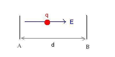

Let we have capacitor plates A and B d distance apart. Let be the potential UA at A (on the left) and UB at B and UA>UB. The electric field is E=(UA-UB)/d, and points to the right, away from the positive plate. The force acting on charge q is F= qE, and the work done by the field when q moves from A to B is W=q(UA-UB). We define change of potential by Ufinal -Uinitial, and the change of potential energy is ΔEPE=q(Ufinal -Uinitial). Uinitial=UA, Ufinal=UB , so ΔEPE=q(UB-UA) which is opposite to the work done by the electric field. W = -ΔEPE.
Your figures:
If you prefer using conservation of energy : The positive charge travels from A to B if UA>UB.
KE(A)+PE(A)=KE(B)+PE(B). PE(A)=qUA, PE(B)=qUB. -ΔKE=ΔPE=q(UB-UA). As UB<UA, UB-UA is negative. What is the sign of ΔKE?
Work-Energy theorem states that the change of KE equals to the work done. So is the work positive or negative?

If the particle goes from A to B the potential difference is UB-UA. You can set UA=0, but in case of positive Δv B is positive with respect to A. If A is positive with respect to B, the change of potential is negative.
Some people use"voltage" for negative potential difference. Look at the problem wording carefully, or ask if voltage is mentioned. How the original problem was worded?

Potential difference means only the magnitude here. The clue is "Motion of the positively-charged isotopes toward the right was initiated by a potential difference of 2500V"The positive charge is repelled by the positive plate so which plate is positive with respect to the other if the positive particle is driven to the right?
Note the difference between potential difference and change of the potential. . Change of potential between an initial and final position is Ufinal-Uinitial. Is the final potential lower or higher than the initial one?
You know the water flows in the direction of lower potential. The same with positive charges. "By themselves" they move towards the lower potential.

Yes, the initial potential is 2500 V (with respect to the final one).

Potential difference between points A and B is not the same as the change of potential along the route of a particle. The first refers too the set-up. The second refers to the moving particle.
The potential difference of point A with respect to point B is 2500 V. The problem said that there is 2500 V potential difference between the plates, but it did no say in what sense. You had to find it out, from he sentence, "Motion of the positively-charged isotopes toward the right was initiated by a potential difference of 2500V". Potential difference meant the magnitude of the difference between the potentials here.
If the positive isotope moved from the positive plate to the negative one, the potential changed from 2500 V to 0 V along its route, it traveled across -2500 potential difference. U final -U initial = -2500 V.
