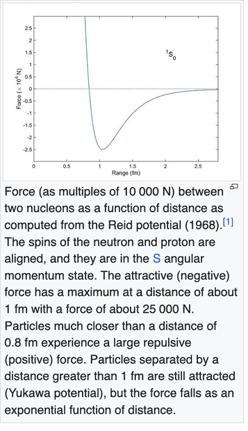

In graph form, via this Wikipedia link, the direction and magnitude of the residual strong force that binds atomic nuclei is as follows:
Graph of force against range between two nucleons, with force in units of 10000 N on the vertical axis and distance in fm on the horizontal axis; the curve dips to about -2.5 near 1 fm and rises steeply to positive values below about 0.8 fm, approaching zero beyond 2 fm.
The range of the residual strong force is a function of the mass of the primary particle (the neutral pion) that carries it between protons and neutrons in a nucleus.

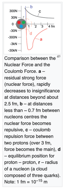

The relative strengths of the residual strong force and the electromagnetic force (a.k.a. the Coulomb force) between two protons is show below (from here):
Graph comparing the nuclear force and the Coulomb force against separation in femtometres, with a small schematic of a proton and neutron pair and labels a, b, c, d and r.
The average distance between protons is the distance at which the attractive pull of the residual strong force balances the repulsive force of electromagnetism, which happens at a little less than one femtometer.
