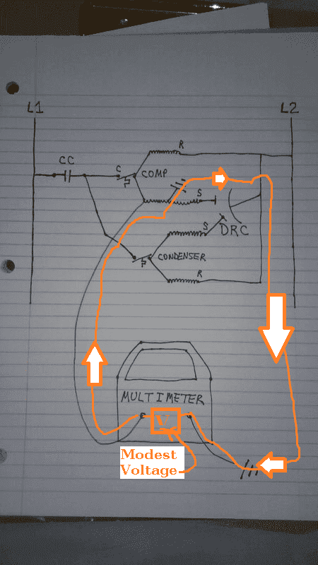

It's my understanding that a person can accurately check whether or not a compressor motor is shorted to ground in the following way: Hold one lead of the multimeter to ground. Then attach one lead of the multimeter to the common spade of the compressor. If there is infinite resistance, that is an indication that the compressor is not shorted to ground. Keep one lead of the multimeter to ground, and attach the other lead of the multimeter to the start winding spade of the compressor. If there is infinite resistance, the start winding is not shorted to ground. If there is a resistance reading less than infinite resistance, the start winding is shorted to ground. Then keep one lead of the multimeter to ground, and attach the other lead of the multimeter to the run winding spade of the compressor. If there is infinite resistance, the run winding is not shorted to ground. If there is resistance less than infinite resistance, the run winding is shorted to ground.
In my thread "Ohm reading when there is a short in the condenser motor", PF member jim hardy told me that when a multimeter is set to a resistance scale, the multimeter actually directly measures not resistance but conductance. jim hardy said that the multimeter applies a modest voltage, typically 1.5 volts from its internal battery, and the multimeter measures the current that flows into the conductance of whatever I am measuring.
Zero current means no conductance which means infinite resistance.
Below is a ladder diagram which shows my understanding of how a person would check for a short to ground:
I have seen videos on youtube in which HVAC technicians have checked for shorts to ground on compressors in air-conditioners, and the HVAC technicians always attached one lead of the multimeter to ground and then attached the other lead of the multimeter to a terminal spade of the compressor.
When an HVAC technician is checking for a short to ground on a compressor, I fully understand why the HVAC technician must attach one lead of the multimeter to one of the terminal spades of the compressor, but I don't fully understand why the HVAC technician must attach the other lead to ground. I understand that the multimeter measures resistance by applying a modest voltage from the multimeter's internal battery, and the multimeter measures the amount of current that flows into the conductance of whatever it is measuring.
Why does an HVAC technician have to have one lead of the multimeter attached to ground when checking for a short to ground on a compressor?
Does an HVAC technician have to have one lead of the multimeter attached to ground when checking for a short to ground on a compressor because having one lead of the multimeter attached to ground is necessary to have a complete circuit?

Your meter on the HVAC motor is similar to the battery/bulb tester. It applies a voltage, like the battery; It has two open ends, like the two wires; it displays a reading if a circuit is made, like the bulb glowing.
And just like the meter, the bulb won’t register until both wires have made the circuit. Current can’t “flow into” something unless it can also flow out. Current flows through something, not either into or out of it.
In your diagram, draw an imaginary wire between the two ground symbols (which is, in effect, what’s happening). Can you now see the circuit?

I find it helpful to refer to a picture
then search for the best possible words to describe it.
It makes you think simple and refine your words. Dont be embarrassed to struggle for some time mak ing it unambiguous.. I edit repeatedly.
Thinking real simple now-----
In that picture above
the meter actually measures the current that flows through the little orange "Modest Voltage" block inside itself. That's where the measurement takes place.
In order to get through the meter and be measured, that current has to flow around the rest of the orange loop as shown.
It is often helpful to imagine yourself infinitesimally small, inside the wire and walking around the loop, as if you were carrying a single unit of charge. You have to stop when you encounter an air gap like a lifted lead.
Resistance you just have to squeeze through, but an open stops you dead in your tracks.
old jim
One comment that may help you sort this out.
The "Gnd" symbol in the ladder diagram you drew is a shorthand way of showing that every occurrence of the symbol represents the same connection.
Rather than show a wire going to everywhere that "Gnd" symbol is, they just substitute the symbol. That's doing the same thing as the "L1" and "L2" symbols in the diagram. You don't draw all the places in the plant that L1 and L2 go, you just label them and know that eventually they get back to a power station.
The same is true with the Gnd symbols, eventually all of them are connected together.
