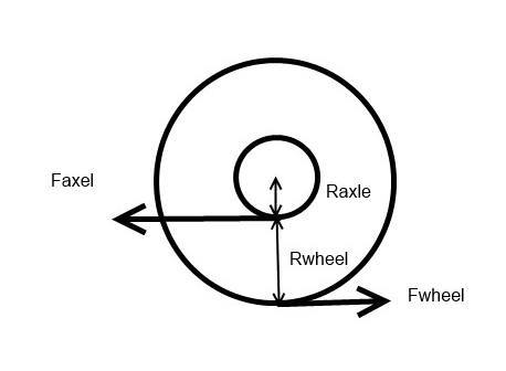

I need to use this formula for a physics prac (my dad an engineer told me it).
F = Weight (normal) x friction coefficient x diatmer of axle)/diamter of wheel
x4 cause the trailer has 4 wheels.
Can anybody point me towards a source of info on it, in particular the derivation.
I use it to calculate the tension force acting between a truck and a trailer.

I think the formulae makes sense if "friction coefficient" refers to the bearing friction. I think that would explain the inclusion of the ratio axel/wheel diameter.
However to that force you also need to add other forces such as that due to rolling resistance and air drag.
Just to explain what I mean...
If you assume constant angular velocity then the net torque sums to zero. So if the bearing or axle friction acts clockwise then friction between wheel and ground must act anticlockwise. These two torques must sum to zero.
(Faxle * Raxle) - (Fwheel * Rwheel) = 0
Likewise the linear forces must also sum to zero so
Ftowing - Fwheel = 0
If you rearrange that lot you should get the original equation.
