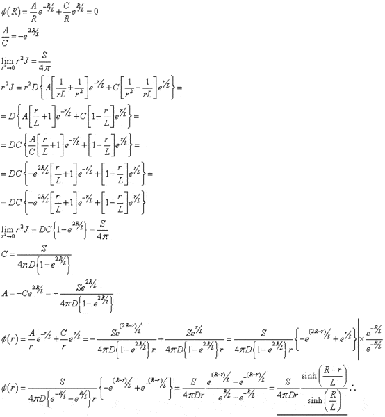

In the text I use for class, the examples and derivations for functions showing the neutron flux at some point, are all about sources within infinite mediums. Now I have a probelm where I must show that neutron flux, for a point source within a finite sphere, is found by the following equation.
[tex] \phi (r)= \frac{S}{4 \pi D sinh \frac{R + d}{L}} \frac{sinh( \frac{R + d - r}{L} ) }{r}[/tex]
If anyone can tell me where I could learn about flux in finite mediums, I would appreciate it.

Here's my work:
[tex]\phi = A \frac{e^{-\frac{r}{L}}}{r} + C \frac{e^{-\frac{r}{L}}}{r}[/tex]
The general solution of point source within a medium flux, A and C are constants.
[tex]\phi (R+d) = A \frac{e^{-\frac{R+d}{L}}}{R+d} + C \frac{e^{-\frac{R+d}{L}}}{R+d} = 0[/tex]
Boundary equation.
[tex]C = -Ae^{-\frac{2(R+d)}{L}}[/tex]
Solving for the constant C.
[tex]\phi = \frac{A}{r}(e^{-\frac{r}{L}} - e^{(\frac{r}{L}-\frac{2(R+d)}{L})})[/tex]
Substituting in the value for C.
[tex]J = -D \frac{d\phi}{dr}[/tex]
[tex]r^2 J(r) = \frac{DA}{ L}(1 - e^{-\frac{2(R+d)}{L}})[/tex]
Note: I took the limit as r goes to zero, so e^-(r/L) goes to 1.
[tex]\lim_{r\rightarrow 0}r^2 J(r) = \frac{S}{4\pi}[/tex]
This is the limit for the left hand side of the above.
[tex]A = \frac{SL}{4\pi D}(1 - e^{-\frac{2(R+d)}{L}})^{-1}[/tex]
Solving for constant A.
[tex]\phi = \frac{SL}{4\pi D r} \frac{e^{-\frac{r}{L}} - e^{(\frac{r}{L}-\frac{2(R+d)}{L}})}{1 - e^{-\frac{2(R+d)}{L}}}[/tex]
Equation after substituting in A.
[tex]\phi = \frac{SL}{4\pi D r} \frac{e^\frac{R+d-r}{L} - e^{-\frac{R+d-r}{L}}}{e^{\frac{R+d}{L}} - e^{-\frac{R+d}{L}}}[/tex]
Simplifying by multiplying numerator and denomator by e^[(R+d)/L]
[tex]\phi = \frac{SL}{4 \pi D r} \frac{sinh\frac{R+d-r}{L}}{sinh\frac{R+d}{L}}[/tex]
That is quite a bit of Latex coding, I will be fixing it if I there is a problem.
That looks right.
Importantly sinh (kr)/r -> 1 as r -> 0.
I have same exercise, but for the line source in a finite medium?
I'm assuming you mean an infinite line source and aren't interested in the ends. It will be a very similar derivation, but you will be dealing with polar instead of spherical coordinates.
theCandyman...you have an extra L in your solution...
This is a more complete solution:
