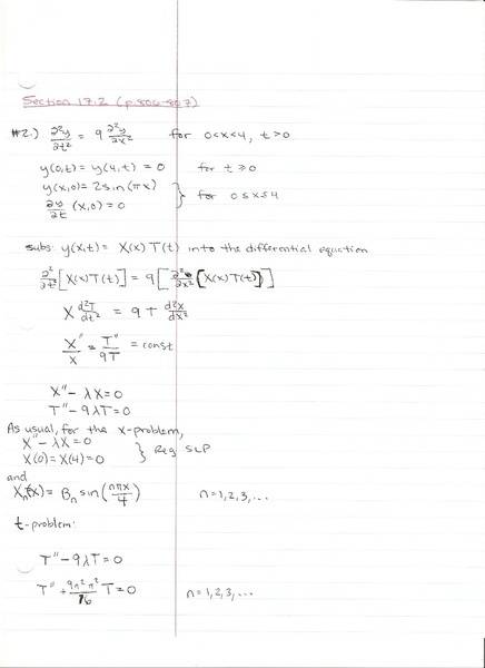

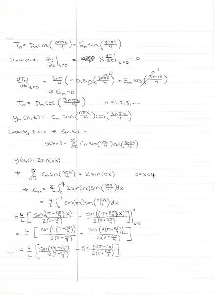

It is a 1-D wave equation problem with fixed ends, no initial velocity, and initial displacement of [tex]2sin(\pi x)[/tex] on the interval 0<x<4, t>0.
See my attached documents of my work. I end up with a c_n value of 0 based on the integration. I am pretty confident I set up the problem correctly as it follows a similar, generalized problem in my class notes. Obviously I used actual numbers in this problem. Can anyone spot any errors in my work? Thanks for your help.

Have you tried to read the thumbnails, ColdFusion85. The quality is poor.
No they aren't. Place your cursor over the picture, the magnifying glass appears. Just click and you will be able to see it fine.

At the end of your first page, knowing that [itex]\sqrt{\lambda} = \frac{n \pi}{4}[/itex] you went from
[tex]T^{\prime \prime} - 9 \lambda T = 0 \text{ to } T^{\prime \prime} + \frac{9 n^2 \pi ^2}{16} T = 0[/tex].
Why'd you switch sign?
You have
[tex]\sum C_n Sin(\frac{n\pi x}{4})= 2 Sin(\pi x)[/tex]
for the initial value and then start calculating a complicated Fourier coefficient.
Isn't it obvious that if C4= 2, all other Cn= 0 satisfies that? Since the sines are "orthogonal", your integral should have been 0 for all n except n= 4. You don't need the full sine series when your function is a single sine!
