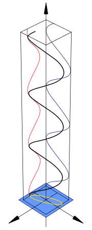

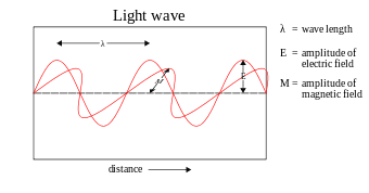

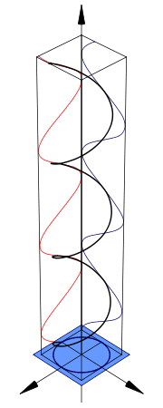

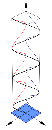

2. What do you mean by "peak of photon amplitude"? All photons of one frequency have the same energy. If they split, then one photon would have to be sub divided - not just into two (for two slits) but into thousands for a diffraction grating.
If you look at those images above, amplitude peaks would describe a helix with certain radius, defining the cross section, or width and height, of our little photon bullet.
3. Do your answers to 1 and 2 extend to photons of LF radio signals with a wavelength of over a km and individual energies which are 10^-10 of the energy of a photon of light? If they don't then you have to think again.
If they don't then there is nothing to talk about. I don't know, could it work like that?
