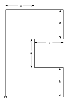

a) Place the origin, O, at the lower left. If the positive x-axis points to the right along the page, what is the x coordinate of the center of mass in terms of a?
b) If the positive y-axis points up along the page, what is the y coordinate of the center of mass in terms of a?
Could u guys help me to start? Thanks so much!
Cut the irregular object to regular pieces (squares). Place the mass of each piece into the centre and find the CM of these point masses.
