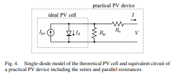

Circuit schematic of the single-diode model of a PV cell with series resistance Rs and parallel resistance Rp, showing current source Ipv, diode Id, and terminals I and V.

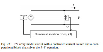

Circuit schematic of a PV array model with a controlled current source labelled I, a computational block labelled Numerical solution of eq. (3) feeding back to it, and voltage V across the terminals; Fig. 23 caption below.
source (Villalva, Marcelo G. 2009. Comprehensive Approach to Modeling and Simulation of Photovoltaic Arrays. IEEE Transaction On Power Electronics, Vol. 24, No. 5)
Fig 4 is the model of PV device. This is modeled by the I-V equation above.
Fig 23 is the circuit model composed of only one current source. The value of the current is obtained by numerically solving the I–V equation. For every value of V , a corresponding I that satisfies the I–V equation is obtained.Is it possible to solve the equation using Runge Kutta method? Could you teach me how to do the first iteration using this method? Or, what numerical method should be used? Thank you...

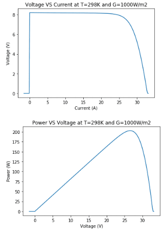

Based on your answers (@Chestermiller and @BvU), I have tried to make the code as follows:

This code produces the following plot:

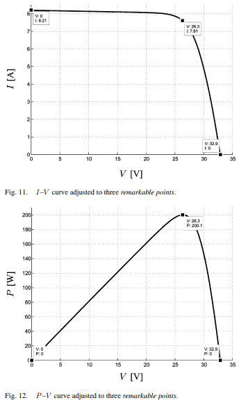

The following image is a picture of the PV characteristics that I use to validate my programming code.
Two plots of a PV module: top, I-V curve with current in A against voltage in V, from about 8.2 A at 0 V to 0 A near 33 V; bottom, P-V curve with power in W against voltage in V, peaking near 200 W at 26.3 V.
source(Villalva, Marcelo G. 2009. Comprehensive Approach to Modeling and Simulation of Photovoltaic Arrays. IEEE Transaction On Power Electronics, Vol. 24, No. 5 )

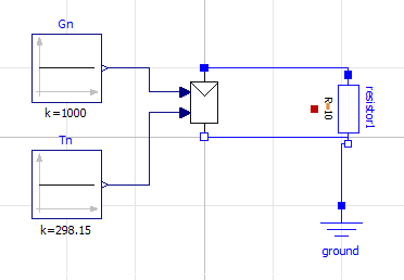

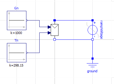

Hi, I want to ask again.
1. I am trying to validate my code above using the source code that I got from PVArray_Verification.
In PVArray_Verification model, the source code is run with openModelica software. The following figure is a PV modeling in openModelica. My code already shows results that match the results from the PVArray_Verification code.
Circuit schematic in Modelica of a PV array: two input blocks labelled Gn with k=1000 and Tn with k=298.15 feed a summing block, which drives a ramp voltage source connected to ground.
2. Now, I try to model the circuit as shown below.

Both of my programs have the same steps / algorithm, which are as follows:
1. I use the x equation to substitute V+Rs*I in the first step. I also and assume that I=1 A.
2. I calculate the value of I(x) to correct my assumption in the first step.
3. I calculate the value of V(x) to calculate the voltage produced by PV array based on corrected current I(x).
The difference between the two programs is:
1. In the first code, I use the voltage value from Voltage=0 V until Voltage= Vocn V in the first step (I use the for loop code to do this).
2. -In the second code, I use the voltage value V=R*I where R=10 Ohm in the first step [I add this step on the 28th and 29th line of code] (I don't use the for loop code to do this).
-I added the code on 45th line to calculate the current accros the resistor.
However, I got the difference results between my result and PVArray_Verification program.
a. My result:
Vpv: 8.412029907464591
I : 0.8412029907464591
b. PVArray_Verification result:
V=31.3 V
I=3.13 A
Would you tell me where my mistake is?
