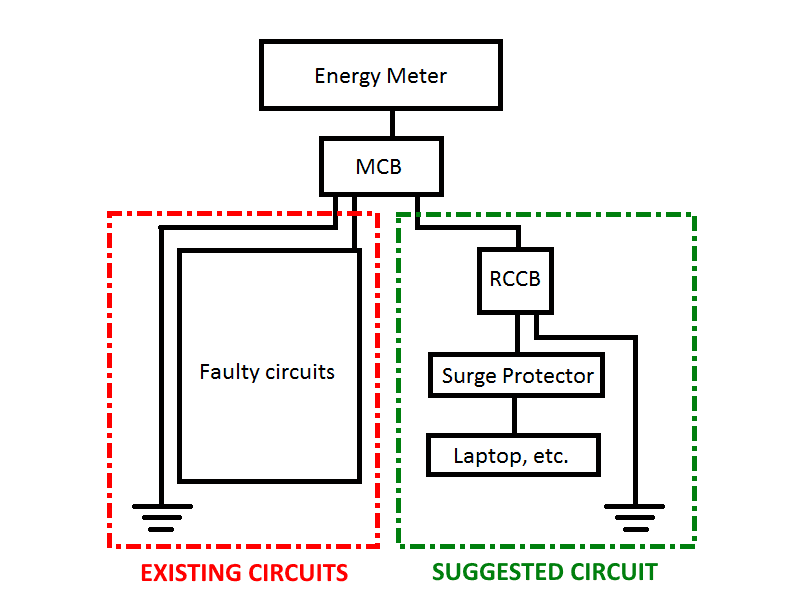

I am facing electric surge problem for last few years at my home. The surge mostly damages electronic gadgets. Both Honeywell and Belkin brand protectors have failed so far. The surge passes through these protectors and blows everything connected to them.
Now, I have been told that issue is because of faulty wiring, which cannot be replaced overnight. So, I have been advised to setup an additional circuit for electronic devices exclusively. As per them, I should have a separate grounding and a Residual Current Circuit Breaker as part of the new circuit shown in the diagram.
I request all of you to please comment whether recommended circuit will be able to give desired surge protection to the connected devices.

What if the faulty connection is located upstream the energy meter or MCB?
A professional electrician should be able to verify whether or not that is the case.

Your proposed solution could help if the problem is at or after the MCB.
Some years ago, a friend had a similar but not as serious problem.
Every time the refrigerator started the reading lamp at his chair would brighten.
After some tracing, we found the voltage surge still showed up at the input to the circuit breaker panel.
Thus showing the problem to be before the breakers, somewhere between breakers and the transformer on the power pole.
In your case it could still be around the breakers, such as a bad Ground/Common connection.
In any case, this is not a situation for an average do-it-yourself project.
Get someone with the needed equipment and knowledge to track it down. (Less likely to burn down your house or end up in a cemetery.)

One thing strikes me as likely to be unhelpful: the idea of multiple grounds.
If the two grounds are at the sane potential, how does that help?
If they are at different potentials, a current will flow, and the electrons will pick the path, not a person. How does that help?

If the grounds are at different potentials, then you have a significant problem that usually isn't properly addressed by adding more grounds. That may just cover up the underlying problem. Such as excessive ground currents from faulty equipment (or maybe wiring insulation failures), or grounds that aren't patent or connected to the wrong thing.

It is hard to make surges in home wiring. They usually arrive from outside.
Do you have three-phase equipment on the premises, or only one single phase?
Do you have any motors with capacitors for power factor correction, maybe they are over corrected?

Service provider's engineers have checked distribution lines and other electricity connections in the area, and told me that random surges are occurring due to faulty wiring at my home itself, i.e., after metering panel and MCB.

Neutral to Earth voltage ≈ 1 to 2 Volt (An unusually large variation was observed few days back: 48 Volt in the evening, then 32 Volt next morning, around 15-16 Volt few hours later, then 1 to 2 Volt as usual).

Faulty single phase wiring cannot "blow things up", as there is no source of higher voltages within the building.
If the ground to neutral voltage is high, then you have lost the connection in the meter box between ground and neutral, or you have bad connections in the neutral wires. That will not produce a surge.

I know nothing about advantages and disadvantages of having multiple grounds. In case, the disadvantages outweigh advantages, then is it okay to reuse existing ground?

Then where does the energy come from, that causes a voltage surge on your property?
If you want to "protect your gadgets", unplug them. Don't plug them back in until the problem is resolved.

My guess is that, the neutral between the power pole and your meter box, is intermittent open-circuit. When open circuit, the neutral current is returning through the earth-stake on the meter box, through local plumbing and neighbours earth-stakes.
An open neutral is a dangerous situation and needs to be fixed by the supply authority.
The surges are from ground currents in the Earth, due to switching, lightning, or magnetic storms.
Installing a new circuit will NOT fix the surge problem.
