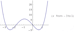

Inflection points for [itex]y=2x^4+7x^3+3x-5[/itex] occur where the second derivative is zero.
These occur at (-7/4, -3713/128) and at (0, -5).
The line passing through these points has the equation, y = (439/32)x-5 .
Subtracting (439/32)x-5 from your function gives, [itex]\displaystyle y=2 x^4+7 x^3-\frac{343}{32}x\ .[/itex]
Here's the graph of that from WolframAlpha.
Of course two of the zeros are at the inflection points. You can then find the other two for the remaining quadratic.

You are a genius. Thanks for helping. There was no need of those calculus methods which were extremely complicated.
