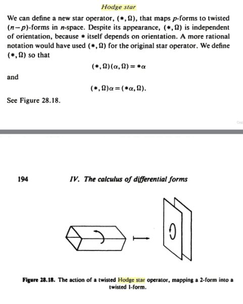

I don't have the full story... I think the following points are relevant.
With pseudo-forms (odd-forms, twisted-forms), there is an orientation in its definition (see p.86),
that is not captured by the notation you are using [not using the general definition used by Frankel].
Definition: A pseudo-p-form ##\alpha## on a vector space ##E## assigns,
for each orientation ##o## of ##E##,
an exterior p-form ##\alpha_0## such that if the orientation is reversed the exterior form is replaced by its negative
[tex]\alpha_{-o}=-\alpha_o[/tex]

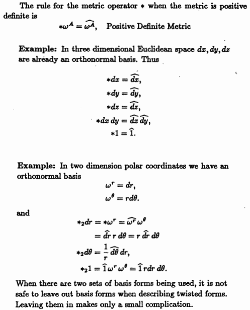

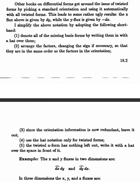

Have a look at Burke's unfinished document
https://people.ucsc.edu/~rmont/papers/Burke_DivGradCurl.pdf
See
  • 18 Twisted Differential Forms, especially the notations at the top of 18.2
    and the "##\widehat{dx} dy## hat notation for missing basis forms" at the bottom of 18.2, spilling into 18.3
  • 27. The Star Operator, especially the notation in 27.2

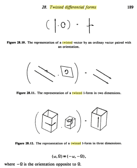

Do a Google-Books search for
"twisted differential forms" "28.10" burke
https://www.google.com/search?q="twisted+differential+forms"+"28.10"+burke&tbm=bks
and notice the orientation that is included geometrical figure.
and
"twisted differential forms" "hodge star" burke
The figures with orientations are likely based on figures in

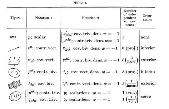

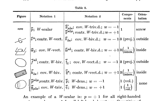

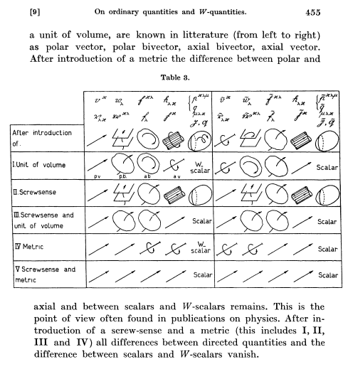

On ordinary quantities and W-quantities. Classification and geometrical applications
J. A. Schouten; D. Van Dantzig
Compositio Mathematica (1940)
Volume: 7, page 447-473
ISSN: 0010-437X
https://eudml.org/doc/88752
http://archive.numdam.org/article/CM_1940__7__447_0.pdf
See also https://www.amazon.com/Tensor-Analysis-Physicists-Second-Physics/dp/0486655822?tag=pfamazon01-20
