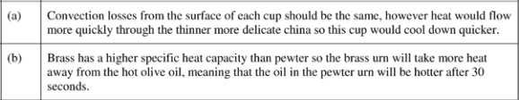

In each of the following, state and explain which container will have the hotter liquid after thirty seconds:
a) You pour equal amounts of of hot coffee into two cup s from a percolator. The cups are the same general size and shape. One is made from heavy china one is made from delicate china.
b) Your pour equal amounts of hot olive oil into two urns. The urns are the same general size and shape. One is made from pewter the other from brass.
2. The attempt at a solution
The solution is a attached but I still fail to understand. From what I can grasp the rate at which heat is transferred in the the thermal conductivity. However in their answers they talk about specific heat. I fail to understand why the loss of heat from the liquids are not constant.
delicate china conducts the heat faster than heavy china so it will be cooled faster.
That is similar to the understanding I had however the answers in the book do not talk about conductivity and rather answer in terms of specific heat, is there anyway to explain it using that.
Also is there reasoning behind delicate china heating faster than heavy china?
Thanks for your help!

In no way am i doubting you are correct however the answers state the opposite. They say the higher specific heat means it will take more heat away.
well there are three parts of the system -
liquid ; container ; surrounding atmosphere
my arguments were for the cooling of container by the surrounding applying the Newtons law of cooling.
if one focuses on the liquid only
the higher specific heat containers can take larger amount of heat energy due to its specific heat -and the conduction transfer is proportional to difference in temp also ; that will take away more heat energy
and they are correct - the liquid will be cooled more in higher specific heat material/containers.
i revise my arguments but stand on the ultimate cooling of the system of liquid+container.
