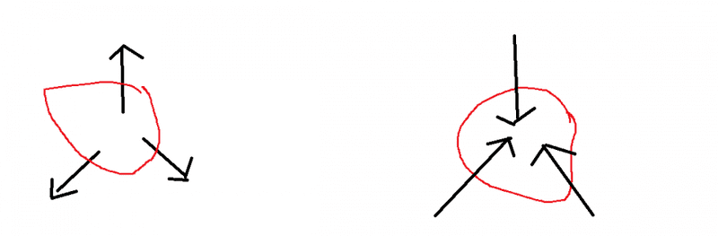

Which is the correct diagram for concurrent forces? The left or the right one ?

Both diagrams are identical.
no , one is all the forces acted towards the circle , the another one is forces away from the circle..Which is the correct diagram for concurrent forces?
Ah, so there is a context.
My answer was based on the idea that a force can be moved along its line of action.
Apparently the circle represents something that can be deformed so that the above rule doesn't apply any more ?

assuming they are the similar circle , no deformation occur (rigid body)Which is the correct diagram for concurrent forces?
Sorry, I still don't get what this is about. What are concurrent forces ? And what would those forces be if they were not concurrent ? Countercurrent ? Cooperative ?
Ah ! Google to the rescue. Concurrent means the lines of actions are going through one single point
Really a good source, this google search: both pictures are concurrent forces. One is compressive.
See here (simple google!)
And now that we know what we are looking for: the inwards or outwards isn't the deciding factor. Protract the force lines and see if they go through one single point.
For experts only: the problem statement is incomplete if it doesn't state that the forces shown are coplanar !

no, this is not an exercise . I just don't understand the notes given by my lecturer , and i ask here
I see. All clear now, I hope.
