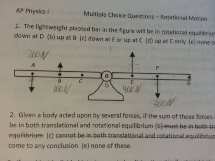

The lightweight pivoted bar in the figure will be in rotational equilibrium when a 200N force acts
Printed AP Physics I multiple choice questions on rotational motion showing a lightweight bar pivoted at D with forces of 200N at A, 400N at E, 300N at F, and a labelled 160N near B, plus question 2 text about translational and rotational equilibrium.
(a) down at D
(b) up at B
(c) down at E or up at C
(d) up at C only
(e) none of these
Torque = Force x Distance
∑Torque= 0 for rotational equilibrium
I know that in order for the bar to be in rotational equilibrium, the sum of torques must equal zero. My problem is that the problem does not give me information about the distance the forces act. In my opinion the problem does not give me enough information to answer the problem correctly.
Therefore I chose e which I am not sure about either.
It looks to me as if you are supposed to assume the points are equally spaced, AB=BC=CD=DE=EF=FG
and to neglect the weight of the "light" bar.
