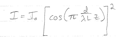

Monochromatic plane waves of wavelength 537nm are incident on two narrow slits and produce an interference pattern on a wall 3.1m away. The slits are spaced 26 micrometers apart and are 5.7 micrometers wide each. What is the ratio of intensity to that of the central fringe a distance of 35.5mm from the central fringe?
2. Relevant equation
I=I0(cos(∏(d/(λL)z))
I tried using this formula to find the intensity of the central fringe and also the intensity of the fringe 35.5mm from the central fringe, however, I could not determine what I(sub)naught was.

Your formula is correct, as you have it in the link. You left out the exponent of 2 when you typed it out. They simply want you to compute the ratio ## \frac{I}{I_o} ##. You should be able to do that using your formula. (Usually the letter ## x ## is used instead of ## z ## in this formula. In any case, ## z=35.5 ## mm). You should be able to figure out what ## d ##, ## L ## and ## \lambda ## are.

That makes so much sense! Thanks a lot for your time!
