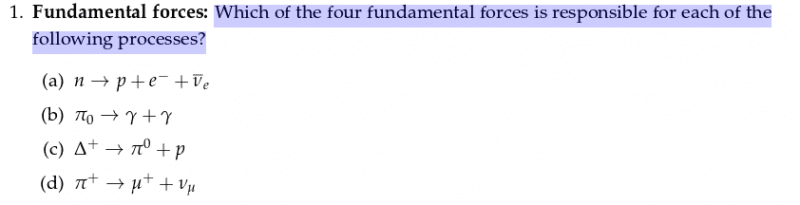

I have been getting ready for my Intro to Modern Physics final. The professor likes to ask a lot of questions like
Which of the following neutron reactions proceeds via the electromagnetic force?
Or something like this...
Screenshot from 2015-04-25 00:00:14.png
I have been looking all over the internet and my textbook. All I can find is kind of vague guidelines for this. How would I go about figuring it out?
I think the answers are Weak, EM, Strong, Weak (Just not completely sure why).

You say you are not sure why, but what do you think?
I think I might have figure it out.
a) The weak force is needed to produce nutrinos.
b) If there are photons this implies EM
c) Strong because of baryons.
d) Weak because of neutrinos.
Correct. Neutrinos only interact through the weak interactions.
What about ##\pi^+ \to \mu^+ + \nu_\mu + \gamma##? This has photons, but also neutrinos.
What about ##K^+ \to \pi^+ + \pi^0## or ##\Lambda \to p + \pi^-##?
Correct.
If you're familiar with Feynman diagrams, try drawing the ones that represent a particular decay.
