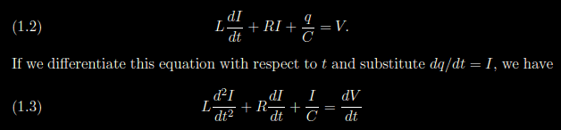

Two typeset equations from a textbook: (1.2) L dI/dt + RI + q/C = V, followed by the text 'If we differentiate this equation with respect to t and substitute dq/dt = I, we have', then (1.3) L d²I/dt² + R dI/dt + I/C = dV/dt.
When the textbook differentiated with respect to time, I see that the middle term is R(dI/dt). Why can't it be I(dR/dt)? When I differentiate, how do I know which letter to differentiate?

L, R, and C are constants. You are differentiating with respect to time and the constants don't vary.

R is a constant just like L and C. You had no objection to treating them as constants.

I see... If I look at the original equation (1.2) has ##\frac{dI}{dt}## and that tells me that I is not a consant?

Actually, it helps to understand something of the physics behind this problem.
V is voltage or emf. I is current.

The example was on differential equations in general, so the textbook didn't give me background information on the physics.

You could use the product rule, differentiating the product RI w.r.t. time. What result would you get?
