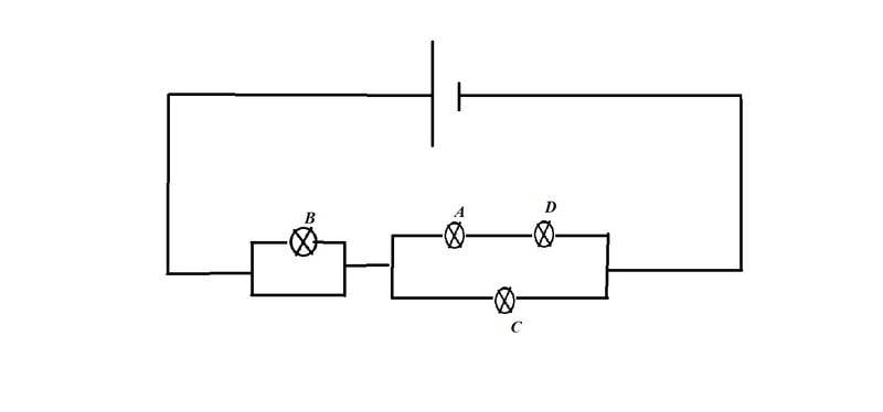

In the picture below we see a circuit with four lamps. The question is which of these lamps shines weaker
Kirchhoff's circuit laws
The true answer is B. But I don't understand why!
I know:
Kirchhoff's circuit laws : ∑In=0
Circuit schematic with a battery on top, lamp B in series with a parallel branch containing lamp C on the bottom path and lamps A and D in series on the top path.
If we assume that a current that goes from plus to minus, before it passes through lamp B, I know that according to Kirchhof's laws, part of the current will pass through the bottom path where there is no lamp there, and another part through the lamp B. Then all of the current wants to go and then split to the next intersection ie part of the current wants to pass through the lamps A and D and another part through the lamp C.
The one I do not understand in this figure is B parallel with the three lamps (A, D, C) or is it in series? Why do we say that B shines weaker?
Say ##I_A## is current through A
[tex]I_A=I_D[/tex]
[tex]I_B+I_O=I_A+I_C[/tex]
where ##I_O## is current through wire parallel to B with no lamp.
[tex]I_O >> I_B[/tex]
because of scarce resistance of wire.

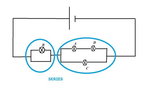

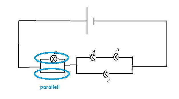

Thank you! But is B in serie with A,D,C or is in parallell ?
B, as such, is neither. The system consisting of B and the wire that bypasses it is in series with the system consisting of A, D and C.
If the bypass wire had zero resistance, why would any current go through B?

It is unfortunate that you "know" that, since it is wrong. Assuming an idea circuit with no resistance in the wires, why would any of the current pass through B ?

No, I mean it is ZERO. Do you understand what a short circuit is, what it does?

The short answer is that B is shorted.

  • Circuit schematic with a battery on top and four lamps labelled A, B, C and D; B sits in a branch on the left, A and D are in series on the upper branch on the right, and C is on a lower parallel branch, with the parallel branches circled and labelled parallel.

  • Circuit schematic with a battery on top and four lamps labelled A, B, C and D; lamp B is in a branch on the left, and A, D and C are arranged in a parallel section on the right, with the two groups circled and labelled SERIES.
