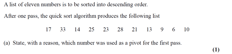

Consider the following array of numbers ##[ 17,33,14,25,23,28,21,13,9,6,10]##? which number was used as the pivot?

Okay i know the answer as indicated on ms ...i just want to check if there is a general rule for finding the number used as the pivot?

The pivot for what?

For doing what with the numbers indicated on that list?
The word "pivot" only means something in the context of certain algorithms, please explain what algorithm you are using that involves a pivot.
Note in particular that the first-fit decreasing bin packing algorithm does not have a pivot.

Is it? How?

From ms again. I'll post the Ms here again for your reference.

Okay, this was the question
With the full question shown, it turns out that the term pivot didn't have anything to do with bin packing, but it was relevant to quick sort.
After the first pass, and since the list should ultimately be sorted into decreasing order, the pivot should be such that all the numbers in the left part should be larger than the pivot, and all numbers to its right should be smaller. Evidently, 13 was used as the pivot.
