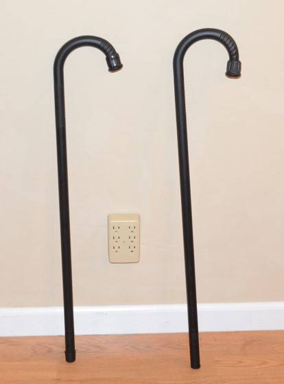

This is a walking crook cane. There are a lot of attacks unprovoked on older Asians.
How about the physics part, I am curious on the physics portion. I am not a mechanical engineer, so this might sound stupid.
