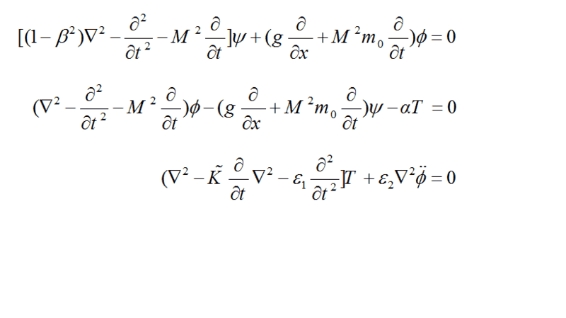

I've a system of partial diff. eqs. in thermo-elasticity, I can solve it using normal mode analysis method but I need to solve it using laplace or Fourier
Three coupled partial differential equations typeset as equations: first [(1 - β²)∇² - ∂²/∂t² - M² ∂/∂t]ψ + (g ∂/∂x + M²m₀ ∂/∂t)φ = 0; second (∇² - ∂²/∂t² - M² ∂/∂t)φ - (g ∂/∂x + M²m₀ ∂/∂t)ψ - αT = 0; third (∇² - K̃ ∂/∂t ∇² - ε₁ ∂²/∂t²)T + ε₂∇²φ̈ = 0.

You need to try something to see if you are on the right track. We can't just give you the solution.
What do you know about Fourier or Laplace transforms?

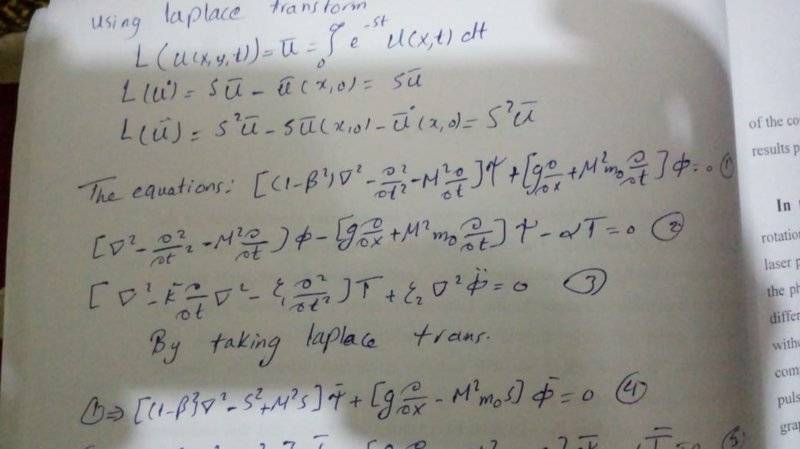

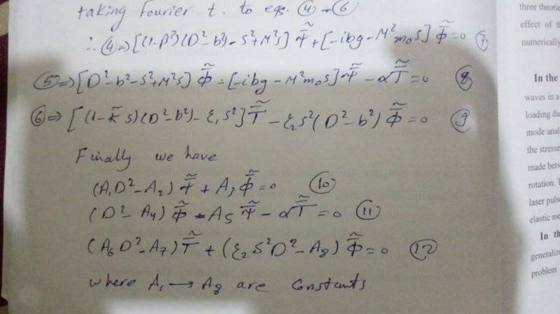

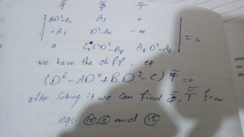

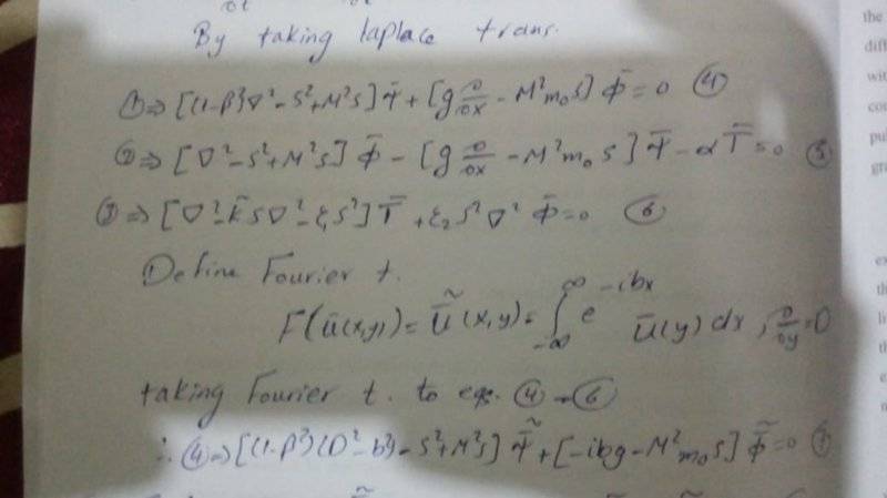

I put my solution i don't its true or false .. i used the laplace trans. then Fourier tran.
sorry for the line sorry for the camera
if the solution is true I've 2 problems
1- I cannot find the inverse of laplace and fourier
2- I cannot write this system on the matlab
so sorry again
  • Handwritten derivation applying the Laplace transform to a system of coupled PDEs with equations numbered (1) to (3), producing transformed equation (4) with bars over the variables.
  • Handwritten derivation: after taking Laplace transform, three coupled equations (4), (5), (6) are listed, then the Fourier transform is defined as F(u)(x,y) = integral from minus infinity to infinity of e^(-ibx) u(y) dx, with d/dy = 0, and taking Fourier transform of eqs (4) to (6) gives equation (7).
  • Handwritten derivation: taking Fourier transform to equations 4 to 6, followed by equations 7 to 9 with bracketed coefficient expressions, then final equations 10 to 12 in terms of constants A1 to A9.
  • Handwritten matrix system with columns labelled phi-tilde, phi-tilde and T-tilde, followed by the characteristic equation (D^6 - AD^4 + BD^2 - C) T-tilde = 0 and a note to find the other transforms from eqs. 10, 11 and 12.
