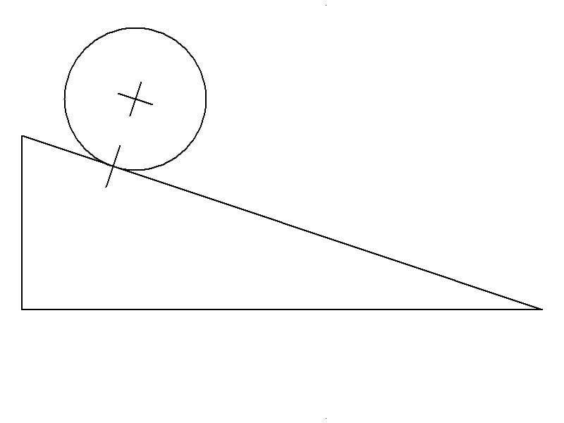

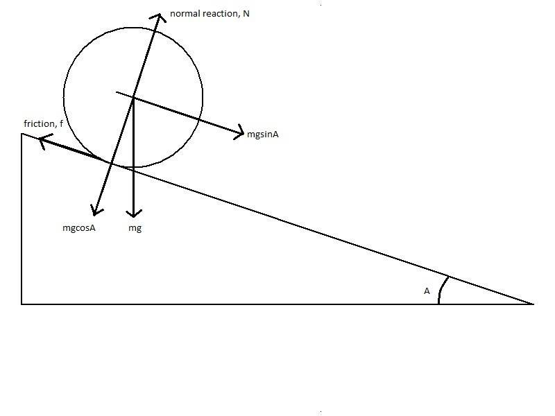

It is always easier to understand these problems using a diagram . Take a copy of the diagram above and mark in whatever forces that you think are acting
OK so,m being mass of the body, here normal force, N = mgcosA and since there is no slipping ( so there is only static friction) the static friction, f should be equal to mgsinA i think. There will be a torque due to the combination of friction, f and component of gravitational force mgsinA. Am i wrong so far? If yes, can you tell me where and why?
If i am not wrong then are the equations i gave in the question applicable here? if yes, then since friction, f and mgsinA are equal and opposite so the net force on the body is 0 right? So, acm= 0 ( since Fext=0) which must not be right. Or is Fext= mgsinA as friction is internal force to the system and, thus, the acm= gsinA? Here is my confusion. Can you tell me how to get the right acm? and what's wrong with my method?
You keep repeating that, but it is not true. Your intuition is blocking you. Just work with the free body diagram and the standard laws, Fnet=ma, τnet=Iα, and the rolling condition a=rα.
Fot the torque equation, make sure to use the same axis for both torque and moment of inertia.
When you have worked that through, you can see for yourself how the static frictional force differs from mg sin θ.
