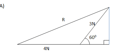

Two forces of 3 N and 4 N are acting at a point such that the angle between them is 60 degrees. Find the resultant force.
##tan(q) = \frac{3. sin60^0}{4 + 3.cos 60^0}## = 0.472
243998
Magnitude R of the resultant force is R =
##\sqrt {3^2+4^2+2∗3∗4∗cos60^0}##
= ##\sqrt {9+6+12}##
= ##\sqrt 37 = 6.08 N##
Direction of R is given by finding the angle q,
##q=tan^−1(0.472)q= tan^−1(0.472) = 25.3^0##
Thus R is 6.08N in magnitude and is at an angle of ##25.3^0## to the 4N force.

Wrichik Basu said:
The formula ... have that derivation.
My Question is why ##3.cos 60^0## added to 4?
Because the x component of R is 4 + 3cos60°. Seethe diagram in the link posted by @Wrichik Basu.
Make a scale drawing using a ruler and protractor. You will see the "end" of R is further to the right than 4. This is because the angle between the 4N and the 3N is not 90 degrees.
So is my diagram in the post wrong?
It's not wrong because your diagram is not to scale. If, however, you draw a very accurate diagram, measuring every length and angle properly, it will deviate from what you've drawn. But most of the time (say about 98% of the time), such precise diagrams are not required if you solve the problem analytically. An accurate drawing, however, will help you visualise the robben better.

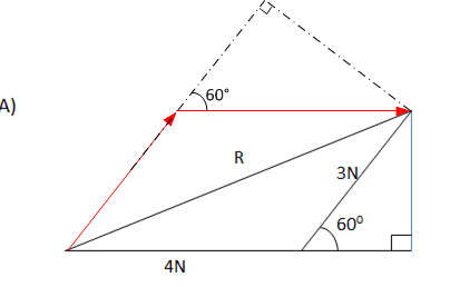

I think this is the correct diagram:
244053
But my doubt position of 4N and 3N. Why 4N need to be in base (or) why not 3N need to be in base?

You cut the left (red) triangle form the original parallelogram and move it to the other side: You get the blue right triangle with hypotenuse R and legs 3cos(60 ) and 4+3sin(60), and angle q. θ=60, the angle between the 3N and 4N forces.
244054
No need for doubt: if you place the 3 'in base' and add the 4 you get the same resultant R :
244056
In other words: vector addition is commutative
This is what @Gaussian97 means when he/she writes 'It's not important'.
So are you saying ##\frac{4. sin60^0}{3 + 4.cos 60^0} = \frac{3. sin60^0}{4 + 3.cos 60^0}## ?
The first one is the tangent of the angle between R and the 3N
The second one is the tangent of the angle between R and the 4N
This last one has been chewed out in this thread already.
For the ##\frac{4. sin60^0}{3 + 4.cos 60^0} ## do you see the line segments sitting there in my sketch ?
Don't click before you have your own answer
(successively: the right dash-dot line (i.e. opposite), the 3N plus the left dash-dot (adjacent).
