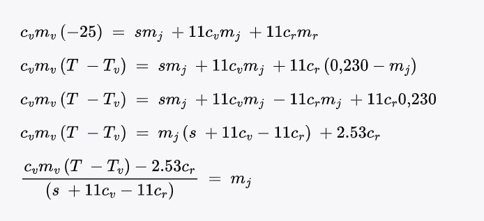

1.5 dl of water at skin temperature of 36 °C was placed in a well-insulated thermos container. An icy piece of iron, including its mass, was added, weighing 230 g and at a temperature of 0 °C. After thermodynamic equilibrium was established, the ice had melted from the iron piece and the system's temperature was 11 °C. How many grams of ice were attached to the iron piece? The heat capacity of the thermos container can be assumed to be negligible, and the density of water can be estimated with three significant figures as 1000 kg/m³.
c_r = 0,449 kJ/kg*K (r is for Iron in my language)
c_v = 4,19 kJ/kg*K (v is for water)
s = 333 kJ/kg
The answer should be around 39g. I keep getting around 45g.
This is the calculation I tried
Any feedback on what I am doing wrong ?

Can you please add some text to describe what you are doing in your equation. I'm not able to figure out how you approached this.
In my approach, I tried to emulate my equation based on what I learned in the theory of this topic:
"Heat is conserved in any such process, consistent with the law of conservation of energy. The amount of heat lost by a warmer object equals the amount of heat gained by a cooler object."
In this case water, the warmer object lost heat, and the iron and ice gained heat
Change in internal energy of original water = (100)(4.19)(-25)
Change in internal energy of ice = m(333)+m(4.19)(11)
Change in internal energy of iron = (230-m)((0.449)(11)
where all masses are in grams.

You can see that your very first equation
is incorrect. The left hand side of the equation is a negative umber while the right hand side is positive. @Chestermiller provided you with expressions for the changes. How can you put them together in an equation?
Would I put a "-" sign before the c_vm_v(-25) ? like -ΔQ_1=ΔQ_2 ?

ΔQ_2 + ΔQ_1 = 0. In a closed system the energy is conserved, no energy is lost or gained.
-ΔQ_1=ΔQ_2 . The amount of heat/energy lost by the water in this case is equal to the heat gained by the melting of the ice into water, the warming of the water, the warming of the iron.
Then I end up back at my equation again.
Edit: I forgot to put the minus sign in the beginning again, sorry.
After the equation I tried solving for m_ice
So what did you get?
Rounded to 45 grams. The exercise says the answer should be 39 grams
I get 39 C from my equation, replacing the 100 gm with 150 gm in post #4.

The sum of the left side and the right side should be zero.

The exercise is correct. Maybe you need to brush up on your algebra for solving a linear algebraic equation in one unknown?
Could be, no doubt. I just wondered since you said you changed the mass to 100g, and then got the desired result of 39g. The mass of the ice should be around 39 grams. I will check my algebra and come back
The initial mass of the water is 150 gm (1.5 dl). I mistakenly took it to be 1.0 dl. With 100 g of water initially, I would have obtained 24 gm for the final result.

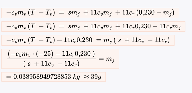

I got it correct now, thank you all for the help.
The mistake was the missing "-" sign in the left part like @kuruman pointed out, the algebra itself was correct.

That would be the case if the unknown in the equation
were ##m_v##. The unknown mass of ice here is denoted by ##m_j##.
