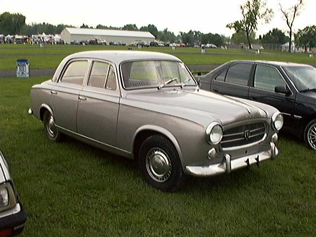

PS I drove a Peugeot 103 for a while.
I had to look that up. I forgot about their mopeds. Peugeot cars are pretty rare in the US now. When I hear the name I think of these. We called them "pig outs" when I was a kid. I guess they were actually pretty nice cars.
Vanadium 50 said:
There is the Honda Fit. But I get your point.
...Peugeot 103
