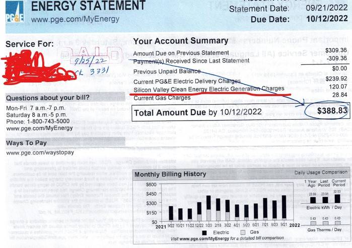

I just look at my PG&E, I use about 22KWh a day, I have AC and all that, my bill is like $400/mo. Now compare to the small Tesla 3 battery, it's 57.5KW
https://ev-database.org/car/1555/Tesla-Model-3
Meaning one charge use like 2 1/2days of my electric bill. That's for driving around 236miles.
If you get a bigger EV like Model S, the battery size is 100KW. One charge is 4.5days of my usage on PG&E.
People do commute to work, I drove like 100miles a day before. meaning my electric usage will be DOUBLE easily if I have an EV.
So back to the question, can the grid support 50% increase if 50% of the cars are EVs?
Even for California that sounds high by a factor of 2. Please check/verify the numbers on an actual bill. But even still, 236 miles is a lot of driving in 2 days. On a per charge vs per gallon basis an electric is always much cheaper than gas.

I am very sure about my bill. I was looking at the bill to post. The reason is because I am putting in Solar panels right now, all these are important numbers to apply how may panels I need.
Neither 22 kWh/day nor "like $400" are numbers that could possibly have come from a bill. So please, give us the real numbers. And fyi, google says the average for CA is indeed half that:
https://www.energysage.com/local-data/electricity-cost/ca/#:~:text=Electric rates in California,-The easiest way&text=The average residential electricity rate,rate of 20 ¢/kWh.?? Are you saying that your bill isn't really a normal bill from PG&E and is higher than the normal cost of grid power because you're paying-off solar panels? That wouldn't shock me but isn't what you'd implied...
This is the graph of my average bill
High is 25KW, low is 18.74, I average to 22KW.
I know how much I paid every month on PG&E. You know there is penalty if you use over certain amount? Yes, if you conserve, bill will be DISPROPORTIONATELY lower.
As I said, I had to submit all these info, that's why I know it's real.
Thanks everyone, I have a pretty good idea now.
The actual numbers would have been better than a hard to read graph, but clearly that bill includes natural gas, not just electricity.

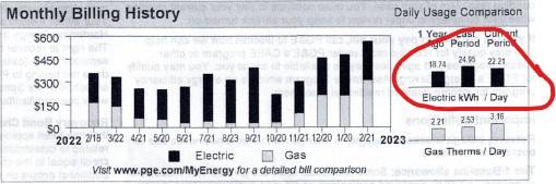

Bandersnatch said:
He marked in red the relevant numbers for electricity only, didn't he?
Not exactly. The other half of the equation for cost per kWh is cost per month, which I'd have to read from the hard to read graph.
(Edit: # of days can be gotten from the graph...).

In Calif, they punish you for using too much gas or electricity. It is NOT linear. That's why I am spending over $80K out of pocket to put solar panels and battery before tax. Whole thing still over $60K after all the tax credit. Of cause it's for black out also as the battery is like $35K alone.
Also, they increase the charge very steep, big difference in 3 or 4yrs. It is still going up. This is copy of bill, you see the$120.07 for Silicon Valley Clean Energy charge? This amount varies with amount of ELECTRICITY used as PUNISHMENT.
This cost is only enough to take care of electricity of the house, It is NOT ENOUGH for charging an EV. I just absolutely REFUSE to buy EV because of the fire hazard. I literally need to double the amount of solar panel to support one EV.
