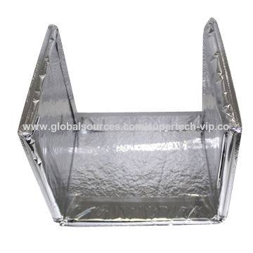

Flat vacuum panels are used in refrigeration. So why not an ice chest? But they are expensive and delicate.
I've read somewhere that the vacuum panels are vacuumed at 100 torr while the vacuum flasks are at 0.001 - 0.00001 torr. I wonder if the difference is that noticeable..?
Edit: Hmm, the panels you've shown have an internal vacuum at lower than 0.0075 torr, according to the manufacture.
All I know is that they insulate better than foam, and if you accidentally out a hole in them, you're dead.
:) Yeah. The tests they do with the YETI ice chest to demonstrate durability by throwing them off a cliff, I suppose would be a bad idea.
