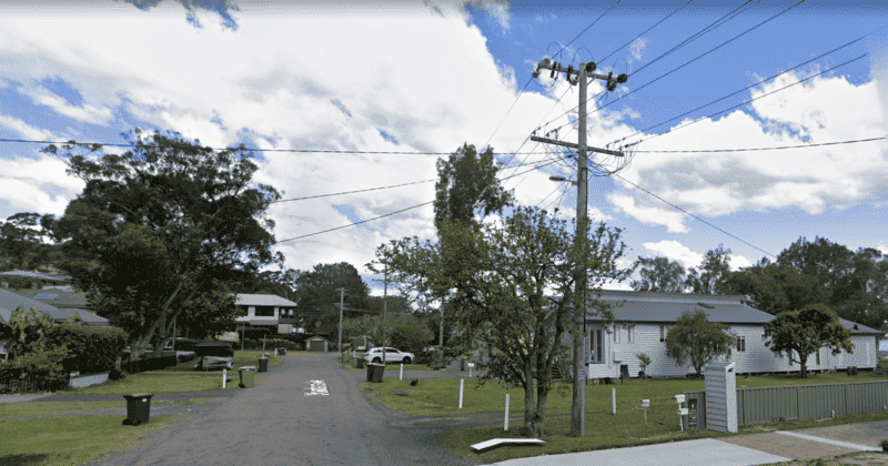

I have a few questions about why modern electrical street wires are wrapped in pairs.
Something I have noticed and have wondered for a fair while is how street powerlines are now wrapped around each other in pairs in my local area (Central Coast, NSW, Australia)In this first pic you can see how they used to be. 3 higher voltage powerlines, and the 4 lower voltage powerlines below (1 for each phase, and a neutral)

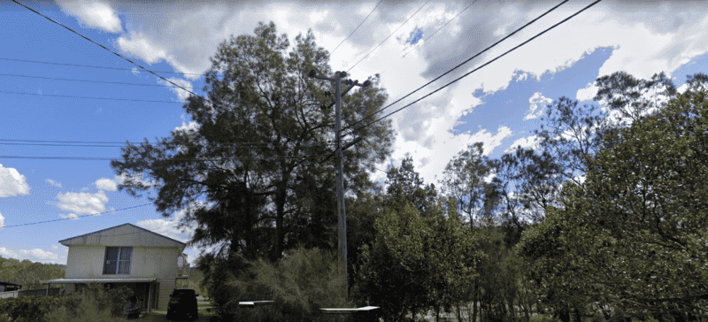

The next pic you can see how they seem to set up powerlines these days. Here is a place where it transitions from 4 separate lines to them wrapped in pairs.
Street scene with a tall timber utility pole and several overhead power lines, beside a two-storey house and tall trees under a partly cloudy blue sky.

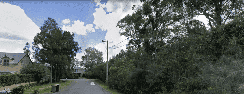

Here is a little more down the road where you can see how the lower voltage powerlines are wrapped in pairs.
Residential street lined with tall trees and bushes, with a timber utility pole on the right carrying overhead power lines, and houses and a grey-green bin on the left.

Are you sure that's a power cable?
Google on twisted pair wiring. It's used in computing and telephone systems. (I'm not a physicist however, so I could be wrong.) It reduces background noise and interference in the transmitted signals.
In the 3rd picture, the lower lines are for phone/TV/Internet, not power.
The rule is that when power and phone share the same pole, the power lines are highest up, and the phone lines lower. The power lines provide shielding from lightning. You would be very unhappy if the phone/TV/Internet cables into your house carried lightning currents.
A second rule is that the maximum allowable voltage increases the higher up we go from the ground. That's primarily a safety reason. If someone or something touches those phone cables, the electric shock will probably not be lethal or start a fire.
That looks like 3 wire, three-phase distribution, at the top of the pole, maybe 11kV. There will be a transformer somewhere nearby that supplies the 4 wires below, being neutral plus 400V 3PH, which is equivalent to three separate 230V single phase lines relative to neutral.
The twisted two-wire cable from the pole to the house has neutral and one 230V phase.
Where a building requires more power, four wires are twisted together to deliver three phases and neutral.

As it turned out, those are called 'Aerial Bundled Cables'

Indeed, they seems to happen more and more frequently these days... I've also just noticed them not long ago.

My 11kV guess for the distribution voltage is probably correct, as the insulators have two discs.
Where houses need to tap off power, the neutral and three phases are run as four parallel wires, but for the run from the corner transition (-33.466474°,151.361884°), to the transformer (-33.466551°, 151.362578°), two twisted pairs are used. Those are the heaviest cables in the pictures.
Most telephone lines in Australia were buried underground, to keep them away from lightning and power poles controlled by another authority. I see no telecom lines in the pictures.
Note that the streetlights on every second pole are connected between two of the 400V phases and have no dedicated control wire running along the street.
I don't think this is the case. I did a Maccas run this morning, and had a bit of a look. There are household supplies where they have the bundled lines. Pictures are compressed when I upload them, so here is a couple of Google Maps links.
The first is at the transformer you're talking about. There is a household supply running overhead. https://goo.gl/maps/NxuyMhGpwz8TLwfg9
Here is the adjacent main road. Same thing. https://goo.gl/maps/Vvo8EEKb2NWHrUGT9
