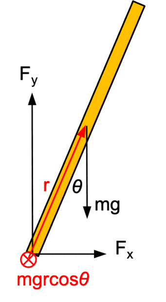

Is this what you have in mind? Shown on the right is the FBD of a tipping plank at an angle on a horizontal floor and rotating clockwise as it falls. The moment is shown in red and is directed into the screen.
For 2D situations like this, moments are either into or out of the screen. If there are more than one, they must all be computed about the same reference point so stacking them all at the same point in the diagram is not really informative.

One is free to choose the reference point about which to calculate moments. If a force is applied at that point, then the moment generated by that force is zero and can be ignored.
You can also see in the diagram in post #4 that the moments generated by ##F_x## and ##F_y## are zero because I chose to calculate moments about the point of contact of the plank with the floor.

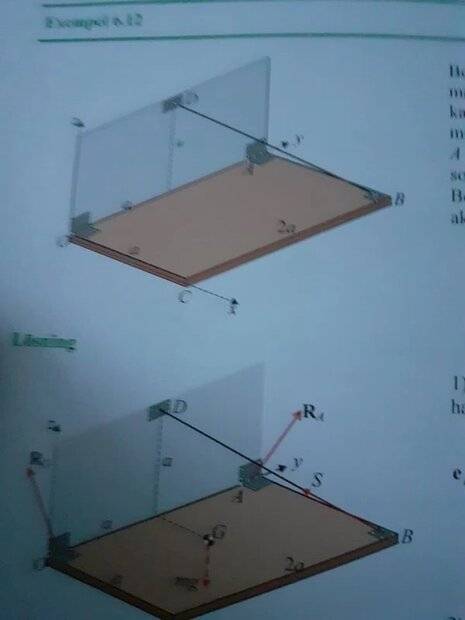

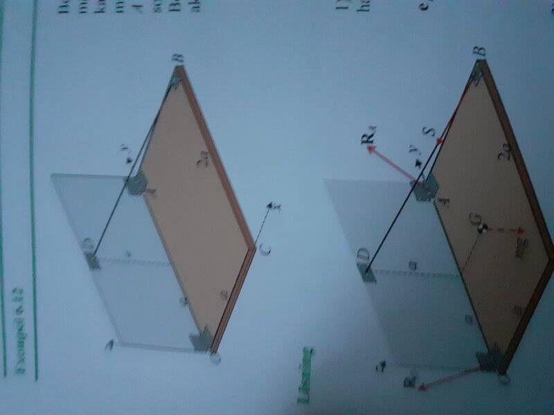

sorry I got confused it is not that picture it is this
At O and A there are hinges but no moment

per persson said:
sorry I got confused it is not that picture it is thisView attachment 346958
If it is a free hinge (no frictional torque) then there is no moment to show.

it says that the door can rotate around the axis OA. How can I determine if it is a free hinge or not?
It is clearly shown as a hinge, and hinges are designed to have very little friction. So assume free unless told otherwise.

But there is rotation around one axes the y axis. But no rotation about the x and z axes. Should there not be 2 moments M_z and M_x because of this?
There is a moment about the x axis and another about the z axis, both caused by the asymmetric rope BD and the weight of the platform.
The result are reaction forces Ra and Ro at the hinges, which are not able to slide over the wall or to penetrate it.
The image showing forces is rather fuzzy and dark, but it looks like the two reaction forces there are in arbitrary directions.
Yes, there could also be moments from those hinges about the x and z axes, but that makes the set-up statically indeterminate. E.g., what if the hinges don't line up perfectly? They would fight each other in a way that depends on how tight the screws are.
Even if the hinges were universal joints, thereby eliminating such moments, the system would be stable. Perfectly installed, the local moments would be negligible. It is therefore reasonable to ignore them.

Why are there no moments at hinges in the FBD?
Because they are free-moving, have negligible friction and have no associated forces?

As is made clear in post #18, @per persson means moments about the x and z axes, where the axle of the hinges is the y axis.
Indeed, if extremely strong, one hinge would do. In that case there would be moments about the other axes.
With two hinges, there could still be such other moments, but if properly installed they will be negligible.
Respect to which axis?
When we talk about moments, it is important to define the axis of reference.
The posted picture shows a situation that may be too complicated for you to fully understand at this moment.
We could try to explain the need or not to represent moments while using a simpler example perhaps.
