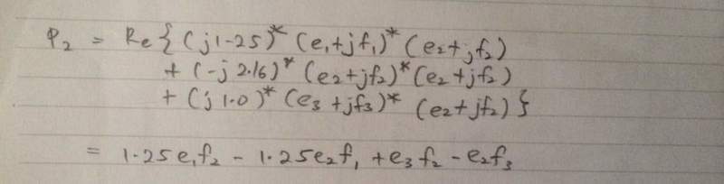

Hello.
This is a power flow calculation of the generator node. I tried calculating several times but I still do not get the same values as this one. This one is the answer, by the way. Can someone explain to me why I got a different answer?
I got:
##P_2=-1.25e_1f_2-1.25e_2f_1+4.32e_2f_1-e_3f_2-e_2f_3##
It's alright now. I just realized the *symbol means complex conjugate.
