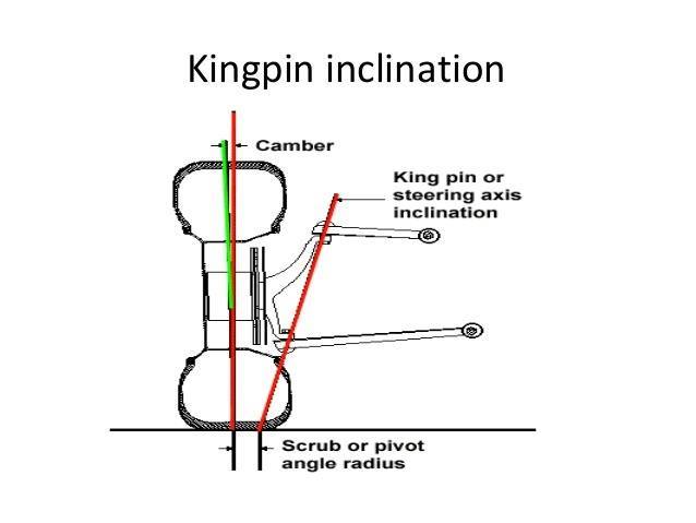

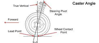

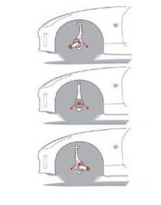

I was on another post on Mechanical Engineering talking about why stiffer springs are more responsive. First of all, Responsive is a pretty much arbitrary thing as you can not hang a number on it. Let us focus on a standard grocery getter commuter car with suspension designed for everyone from Grandmother to the hog dog teenager. When we drive into a left hand turn, forward momentum will cause the car to roll to the right as stationary asphalt causes the tire contact patch to push back on the momentum force. Since we have soft springs which compress under this load we have a steering feed backs that feels like mush.
The trick here is to think in 4-D. In a turn we are dealing with X,Y,Z movement and Time. Things are not 2-D as typically indicated in many discussions on this matter.
The front suspension on todays automobile have spindles that turns via the steering wheel ( thru linkage to the steering box or Rack and Pinion mechanism). These spindles are mounted in such a way that they have caster. Like a fork on a bicycle the top of the front wheel fork is slanted toward the rear and the bottom of the fork is slanted forward. Anyone who ever road e bike knows this arrangement cause self centering which adds to the stability of the steering. Same with the spindle on a race car. The spindle is slanted so the top is slightly behind the axel center line and the bottom is slightly forward of the axel center line. This Caster causes the race car to lift slightly when the steering is turned because the whole arc of rotation is tilted to begin with. Add to this dynamic , the fact that the spindle is made with an inclination angle between 5 and 10 degrees. When the spindle is turned the part that mounts the tire and wheel actually lifts the chassis. The combination of caster and Spindle inclination angle (SIA) can lift the right front of the race car and inch when turning the steering wheel.
By feel, adding a stiffer Anti Roll Bar (ARB) or sway bar ,we keep the car from rolling over like a big old whale in the turn ( stiffer front springs will do the same). With less spring compression to deal with the forward momentum, the tires must take up more of the load being transferred. In most cases they do not and we have a classic under steer condition. Race car Pushes like a freight train. Stiffer springs make the car lift on that corner a lot quicker than the softer springs trying to cope with the load coming forward and then pushing up on that corner of the car due to Caster and KIA. So the steering on stiffer springs / ARB is more “ responsive”.
So what is the answer? Just like in life, balance is the key. A good spring package and sway bar set up and good shocks to time the compression and rebound is the ticket.
