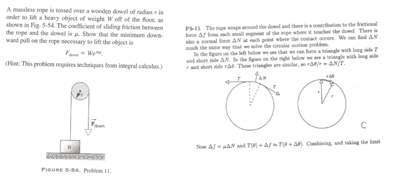

Why Are the Mentioned Triangles Similar in the Explanation?
  • Thread starter user5
    Rope
user5
38
Why in the provided explanation the mentioned triangles are similar?
Thanks in advance
  • Solution diagram for a rope wrapped around a circular dowel: two circles with tension T, normal force ΔN and angle Δθ marked, with similar triangles of sides T, ΔN, r, rΔθ indicated.
The angle is chosen in such a way that they are. (they are isosceles triangles, they are similar if the angle at the center of the circle is the same).
