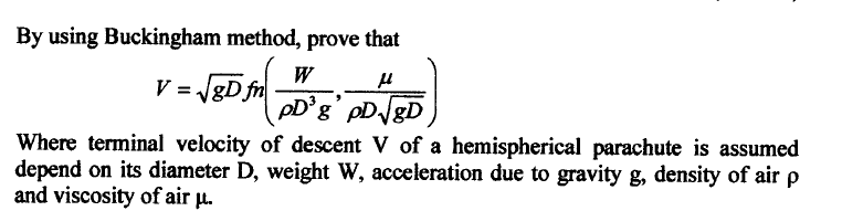

Is the question wrong ?
Printed text stating: By using Buckingham method, prove that V = sqrt(gD) fn(W/(rho D^3 g), mu/(rho D sqrt(gD))), where terminal velocity V of a hemispherical parachute depends on diameter D, weight W, gravity g, air density rho and air viscosity mu.
I found that the number of dimension = 6 , primary dimensionof velocity is L / T , which is 2 , number of repeating variable = 2 , so , there are 6-2 = 4 pi group , why the question only gt 3 pi group ?

Not sure where you get that formula from. As I understand it, you have 6 quantities that, between them, involve 3 dimensions (MLT), so the equation can be written relating 6-3=3 dimensionless expressions.
