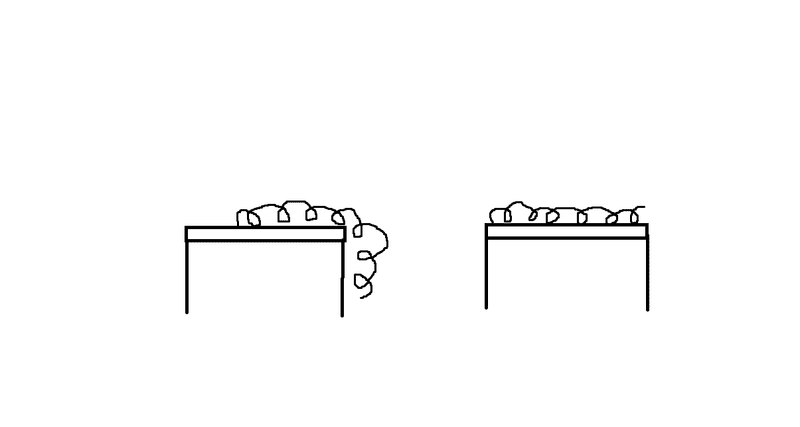

A chain of mass M is placed on a smooth table with 1/3 of its length L hanging from the top. The work done I’m pulling the chain back to surface is?
W=F.d
The force is -Mg and distance is L/3. So W=-MgL/3. Not right!
Maybe it’s done using COM but there is no additional information is given.

That is not easy to tell. Sum of all the PE of elements of 1/3 chain will be initial PE of the 1/3 part and after the chain is on the table its Mg(height of the table)/3.
Is it Mg(height of the table)/3?
The height of the table is irrelevant since the L/3 of the chain is hanging freely. I suggest drawing a picture of the before and after situations if you are having trouble visualizing.
You asked about PE. So its measured from the ground. Height is important. But I don't think its going to solve like that since height is not given.
MgL/18 by taking COM raising it a length L/6.

You cannot use the COM logic here because the chain is not a rigid body, it changes shape as it moves.
How can we do it without the COM concept?
Well @Orodruin is trying to guide you into it. I don't know is I should interfere because I have another way in my mind
Oh well here it goes:
Work does only the weight of the part of the chain that is hanging (which part is different in length as time passes) (why is that can't you think of a reason? More specifically why the supported part (the part that is on the table) does no work with its weight?)
Assume ##x## is the length of the chain that is hanging (at a time t). What is the infinitesimal work ##dW## that the weight of this length ##x## does as it moves ##dx##?
Integrate ##dW## (w.r.t ##x##) to get the total work ##W##

Yes well it depends on what you disagree. The chain is not a rigid body (I hope you don't disagree on that) but yes maybe we can use the COM logic. I wasn't very sure when I was writing that that anyway my way doesn't use COM logic for this problem.
Well, the chain is clearly not a rigid body. However, COM methods work perfectly fine.
I get ##mgL/18## with my way too.

##dW=-Mgdx/3##
Now integrating from 0 to L/6 we get
##\int_{0}^{L/6} -Mg/3 \, dx##
##W=-MgL/18##

Nope you have gone wrong here. The formula you give for dW is wrong and also the boundaries of integration are wrong.
Lets start from the easy stuff. Remember ##x## is the length of chain hanging (NOT the position of the COM) and the chain initially hanging is ##L/3## and at the final position is 0, what do you think the boundaries should be?

Why is my way wrong? I took the COM position as zero and final position as L/6. I applied your concept. Now I think we don't have to apply Integration at all since the force does not vary. Just take the initial PE=0 and take the difference of PE. (Mg(L/6-0))/3
You have blend in your mind my method and the COM method. My method doesn't use COM position, forget COM at all. ##x## is the length of the hanging part which varies from L/3 to 0 as the chain moves. Read again post #11 more carefully please.
Delta2 said:
x is the length of the hanging part which varies from L/3 to 0 as the chain move
dW=-Mgdx/3 but the mass M is varying with respect to x. I think we need the function M(x). What do you say?
Much better, It is actually M(x)gdx, now what do you think M(x) is? We can assume that the mass of the chain is homogeneously distributed.
##m(x)=Mx/L##
##dW=-Mgxdx/L##
Taking limit from -L/3 to 0
we get ##W=MgL/18##
