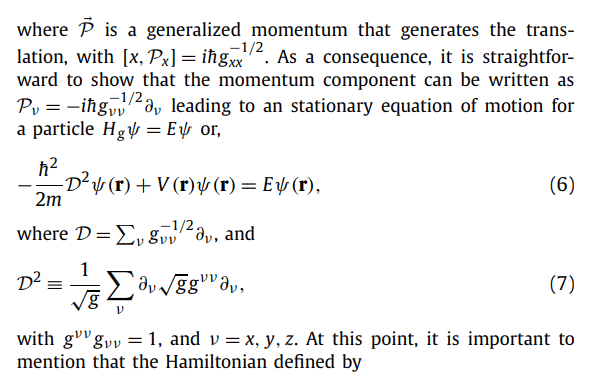

I encountered a problem in reading Phys.Lett.B Vol.755, 367-370 (2016).
I cannot derive Eq.(7), the following snapshot is the paper and my oen derivation,
I cannot repeat Eq.(7) in the paper.
Printed page of a physics paper with equations: a generalized momentum P, the relation P_v = -iħ g_vv^(-1/2) ∂_v, the stationary equation -(ħ²/2m) D²ψ(r) + V(r)ψ(r) = Eψ(r) as Eq. (6), and D² = (1/√g) Σ ∂_v √g g^vv ∂_v as Eq. (7).

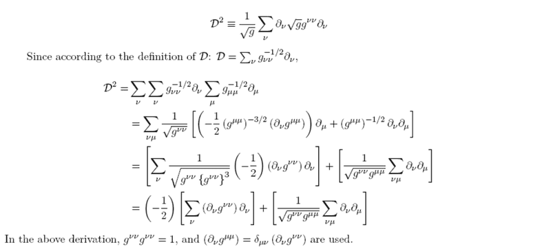

##g^{\mu\nu}## is diagonal metric tensor and##g^{\mu\mu}## is the function of ##\mu## only, ##\mu=x,y,z##.
My derivation is as follows, but I cannot repeat their result and my result contains the cross term differential ##\partial_x \partial_y##.
Handwritten-style typeset derivation of the squared operator D^2 for a diagonal metric, expanding it as a sum over nu and mu of g^{nu nu} derivative terms, ending with a final line containing the cross term sum of partial_nu partial_mu and the note that g^{nu nu} g^{nu nu} = 1.
(The first line is their result), while the last line is mine.
Would anyone can help me to elucidate this problem?
What does the three horizontal lines after ##\mathcal{D}^2## mean in eq 7? It sometimes means that something is true by definition (identical to) https://en.wikipedia.org/wiki/Triple_bar
If this is the case, you can not derive eq. 7.
PRB147 said:
andgμμ is the function of μ only
indices are not variables, thus the metric is not a function of µ.

That's because the equation that precedes (7), namely ##{\cal D}=\sum_{\nu}g_{\nu\nu}^{-1/2}\partial_{\nu}##, is a nonsense. And it seems that the authors of the paper are not well versed in tensor calculus. To see how Eq. (7) should be correctly written and derived, google Laplace-Beltrami operator.

Please use the PF LaTeX feature to post equations directly, not as images. There is a LaTeX Guide link at the lower left of each post window.

thank you for your comment, I thought the author's meaning is ##g_{xx}## depends only on x; ##g_{yy}## depends only on y; etc.
Thank you very much, I will read the relevant references according to your guidance.
No it does not...
