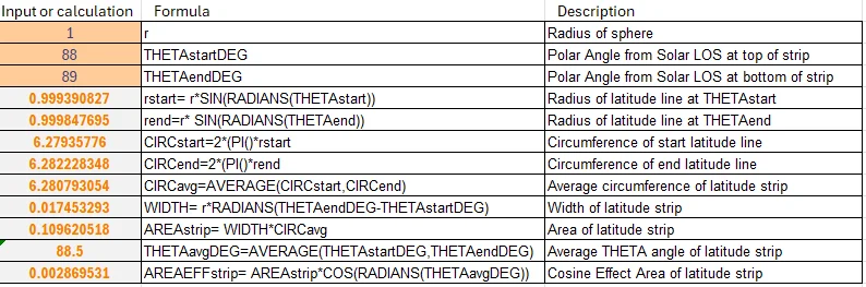

I integrated form 0 to 90 degrees, half a hemisphere, instead of -90 to +90 degrees, a full hemisphere, and assumed symmetry from this arc to a hemisphere. I am not sure I did this correctly, which is why I am asking for someone to check my math.
I don't see enough equations in any of your 3 posts in this thread for readers to check. Don't make us guess! Learn enough LaTeX to post your work here, including basic assumptions, equations, and the form of the integral you evaluated numerically by spreadsheet. A diagram of the geometry you're considering would also be helpful.

Well, I did as close to that as I could. If you were thinking that half a hemisphere has twice the area of a circle of the same radius, that would have been an error.
As @renormalize points out, we can't check your math because you didn't show us your math. You described the math you did, but describing what you did is not the same thing as showing what you did.

I drafted a numerical integration in a spreadsheet over half a hemisphere, and came up with a factor of 0.635. That is, the effective illuminated area of a hemisphere is 0.635 the geometric surface area
The 0.635 seems awfully close to the average value of a half cycle of a sign wave, from 0 to pi, which should be the same for a quarter cycle from 0 to pi/2.
also, please define 'effective illuminated area'. I am not sure what is meant.

I completely redid my numerical integration spreadsheet, and the results seem to support that the Cosine Effect on a hemispherical PV array would have the same output as a disc with the same radius normal to the light rays from the Sun. I made a prototype spreadsheet with the formulas for two adjacent latitude lines. The diagram is at this link:
https://en.wikipedia.org/wiki/Spherical_coordinate_system
Spherical Latitudinal Strip Solar Array with Cosine Effect.
Rays of sunlight are parallel to the polar z-axis.
The spreadsheet has 91 rows, with the first column the THETA degrees from 0 to 90 in 1 degree increments. Each row calculates the area of a strip of latitude 1 degree wide. The sum of the rows for r=1 is extremely close to pi, and given the granularity error of numerical integration, this supports the hypothesis that the Cosine effect area of a hemisphere is the same as the area of the equatorial disc.
For a spacecraft, a spherical array of PV panels will provide the same solar power as a disc of the same radius without a Sun tracking mechanism, but at a cost of 4 times the number of PV panels.
