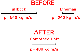

Hello Doc Al,
It seems I peaked too early and I don't understand this much yet.
Now in this picture if I find change in momentum of full back it is.
400-640= -240
Now if the full back lost 240 momentum,then the lineman should have gained it. So line man's change of momentum must also be 240 in opposite direction. When I do the equation it is.
400+240=620
Why is it not equal?
  • #55
400-640= -240
Nope. 400 kg-m/s is not the final momentum of the full back, but the combined momentum of both players. (+640 -240 = 400)
If you new the masses and initial velocities of the players, you could determine their final speed and the change in their momenta.
