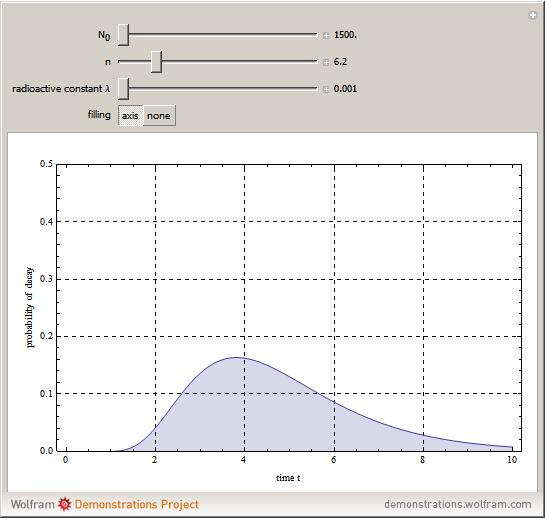

Why do radioactive materials decay in half-lifes exponential decay and not over mean time, i.e. like a Bell Curve

Radioactive decay can be modeled as a bell curve - you just have to be aware of what, exactly, is being modeled:
Wolfram Demonstration panel plotting probability of decay against time t from 0 to 10, showing a skewed bell-shaped curve that peaks near t = 4 at about 0.16 and falls toward zero by t = 10.
http://demonstrations.wolfram.com/RadioactiveDecayAsAProbabilityDistribution/
The "mean time" is the half life.
